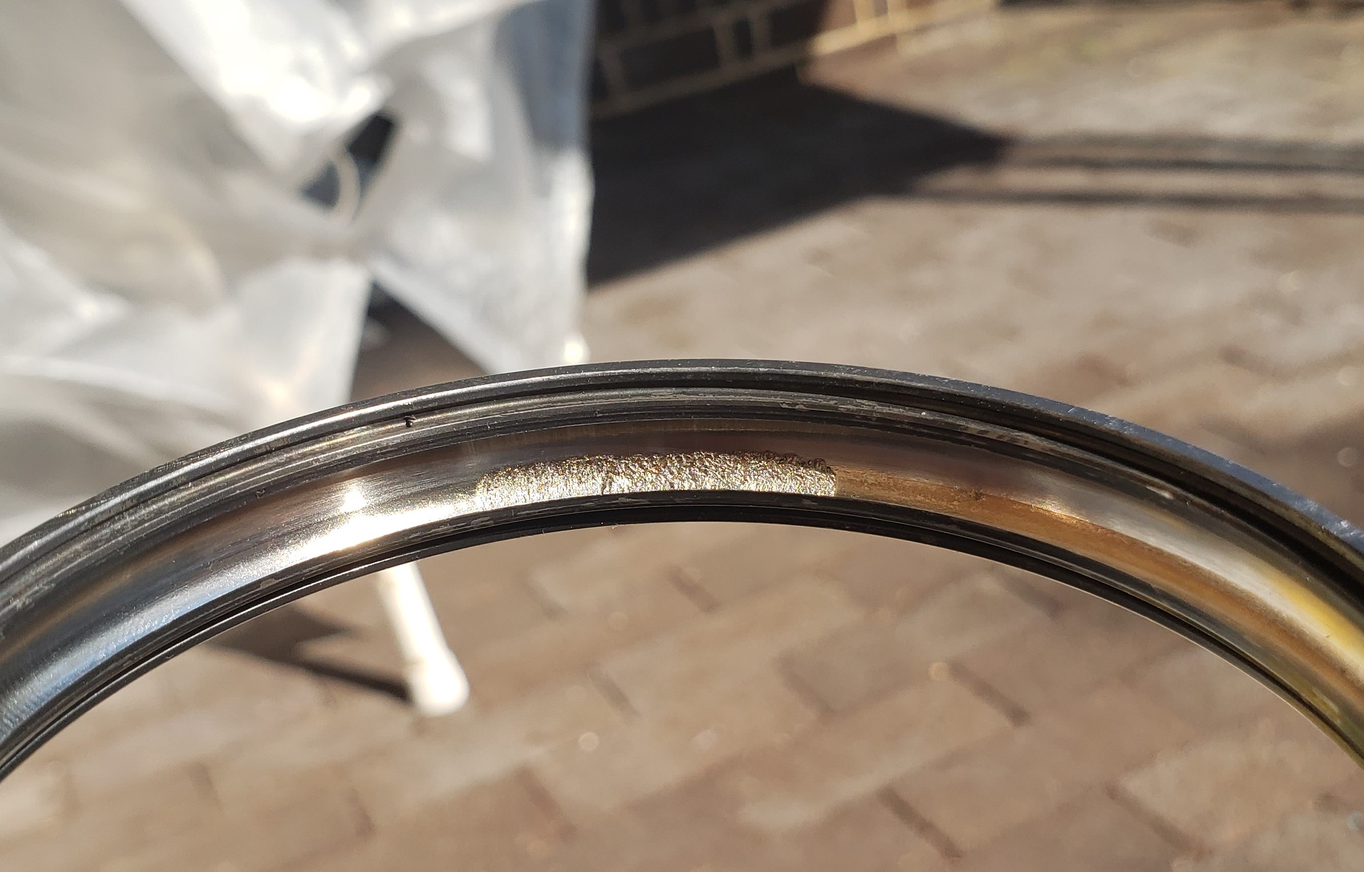

Edit: I took apart the faulty bearing and here is a picture of the outer race. I'm not terribly familiar with types of bearing damage, but this looks like spalling to me. I'm not sure what would cause this though.

Just following up on this. I replaced the one bearing that wasn't smooth. The whining noise from the rear differential is gone. Although I fixed it, I'm still perplexed why the bearing would have failed less than a year after replacing it. Oh well, if it happens again at least I've gotten good at doing this repair.
