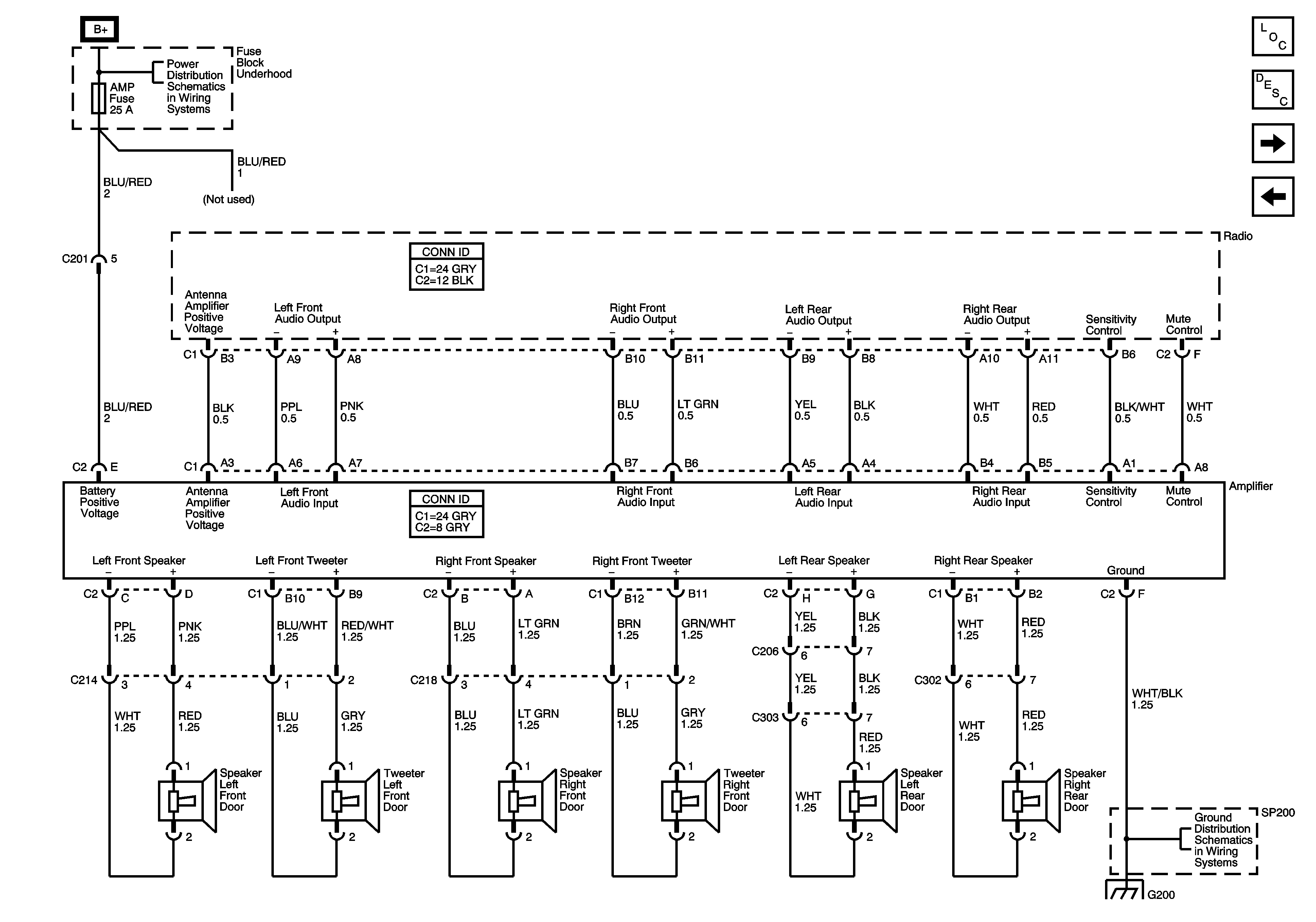

It is possible to bypass the amp, Vibes with and without moon&tunes used the same head units and speakers. I attached a wiring diagram to help you figure that out if you want to go that way You'd lose the tweeters unless you add a crossover, the amp does that now, I never found them to have much effect anyway.
