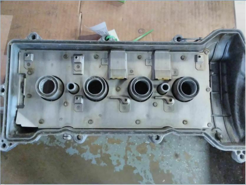

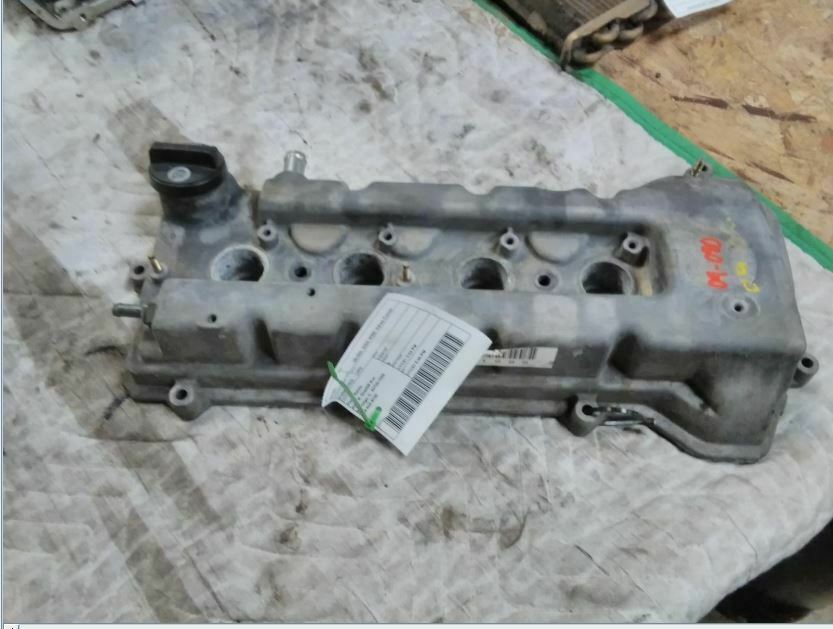

I'm using my daily 03 Vibe Base (130K miles) to learn more about working on cars. Recently I purchased a used valve cover from a wrecked Vibe. It looks like it is in good condition.
I am replacing the PCV valve, valve cover, gasket (+2 grommets), and have gasket maker for the part between the cams and timing chain. I already replaced spark plugs at 120k miles.
My question is do I need to oil up the new valve cover as like a primer? Should I wait to change the valve cover the same time I change the oil? Does anyone have any tips or things to look out for when doing this work? I have owned the car for roughly 55-60k miles and this is the 1st time I am doing the valve cover gasket.
Thank you all. I'm including a few pics of the new valve cover.

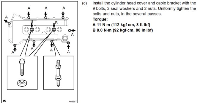

Here's a pic from the 03 Matrix manual about replacing the valve cover, there's no specific torque pattern, but it does give the bolt torque specs. 8 ft-lbs isn't a lot.

yes and no. Different materials have different strengths, so they'll have different maximum torque before they shear or strip. The matrix manual says the torque for the ignition coil bolts is 80 inch pounds which is snug but not really that tight. At 80 in-lbs the type of material isn't going to matter much, you won't shear it off, and shouldn't strip the threads. I don't know what the OEM bolts were made of, but I might go for stainless steel just to prevent any corrosion. Just don't over torque them
