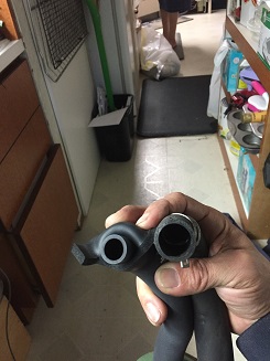

i have a problem, i replaced the pcv and found out that the hose, prolly very old, was cracked , could not found it in autoparts stores, so i ordered online but when i got it ,it was the wrong kind, so my question is since i own a 2004 vibe gt, what is the equivalent in toyota model?

Toyota Matrix XRS of the same generation.

salamander162 wrote: ↑Fri Jan 08, 2021 1:43 pm hello guys
Toyota part # is 12262-22090 for the PVC hose for a 03-04 Matrix XRS with a 2ZZ.

DopeVibeGT wrote: ↑Tue Jan 12, 2021 3:14 am
thanks a lot buddy!!!
