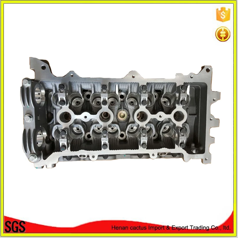

Greetings, could someone tell me approximately how many oil return passages there are in a 1zz-fe and where they're located? I'll attempt to attach a representative photo.

I would say, look at the 3 brown passages on this block, just those and the cam chain passage.
then match up with a cylinder head pic, I think I see 3 next to the head bolts at top of pic

CNYDave wrote: ↑Mon Oct 19, 2020 3:43 pm I would say, look at the 3 brown passages on this block, just those and the cam chain passage.
http://www.corollaforum.com/threads/how ... down.6726/ has a pic of the underside of the head that came off that block
I don't know how /what oil returns there are from the top of the head that drain into the chain area

just behind the sprockets would fill fill oil if there weren't a drain, so I'm pretty sure there is one.
Light looks to be coming through a possible opening in this pic:
