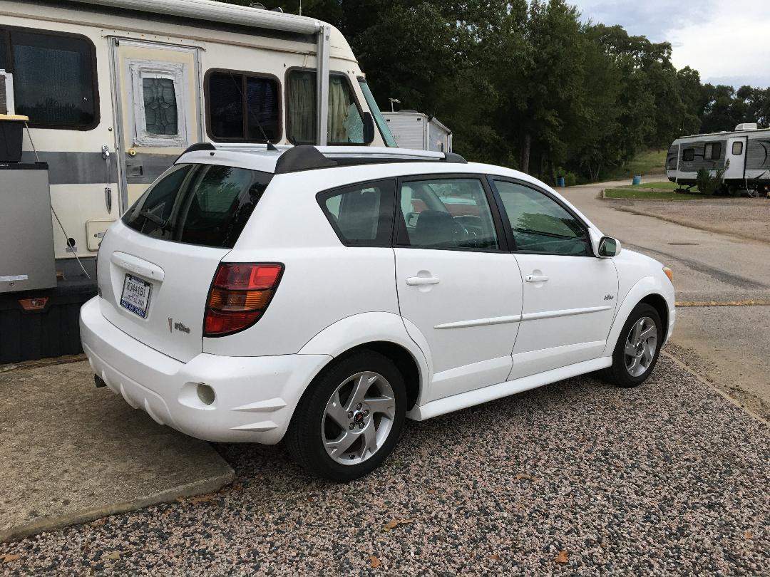

Thanks, everyone! Some quick photos, as requested. I'm still on my first tank of gas, so I haven't even figured the mileage, yet.
I'm actually between dogs at the moment. Lady, my beloved Collie, passed away last Summer. She was the office mascot at my last job and came to work every day since she was a puppy. That's her underneath my desk. But I'm getting ready for the next dog. Needed to replace a slowly dying Chevy pickup with the Vibe, still need to make some home repairs before I can get a another dog (living in the old motorhome in the background, need to get the front A/C repaired before I can leave a dog inside in the Summer). Currently working at Wally World, and they won't let me take a dog to work with me :(
