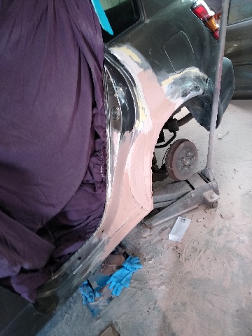

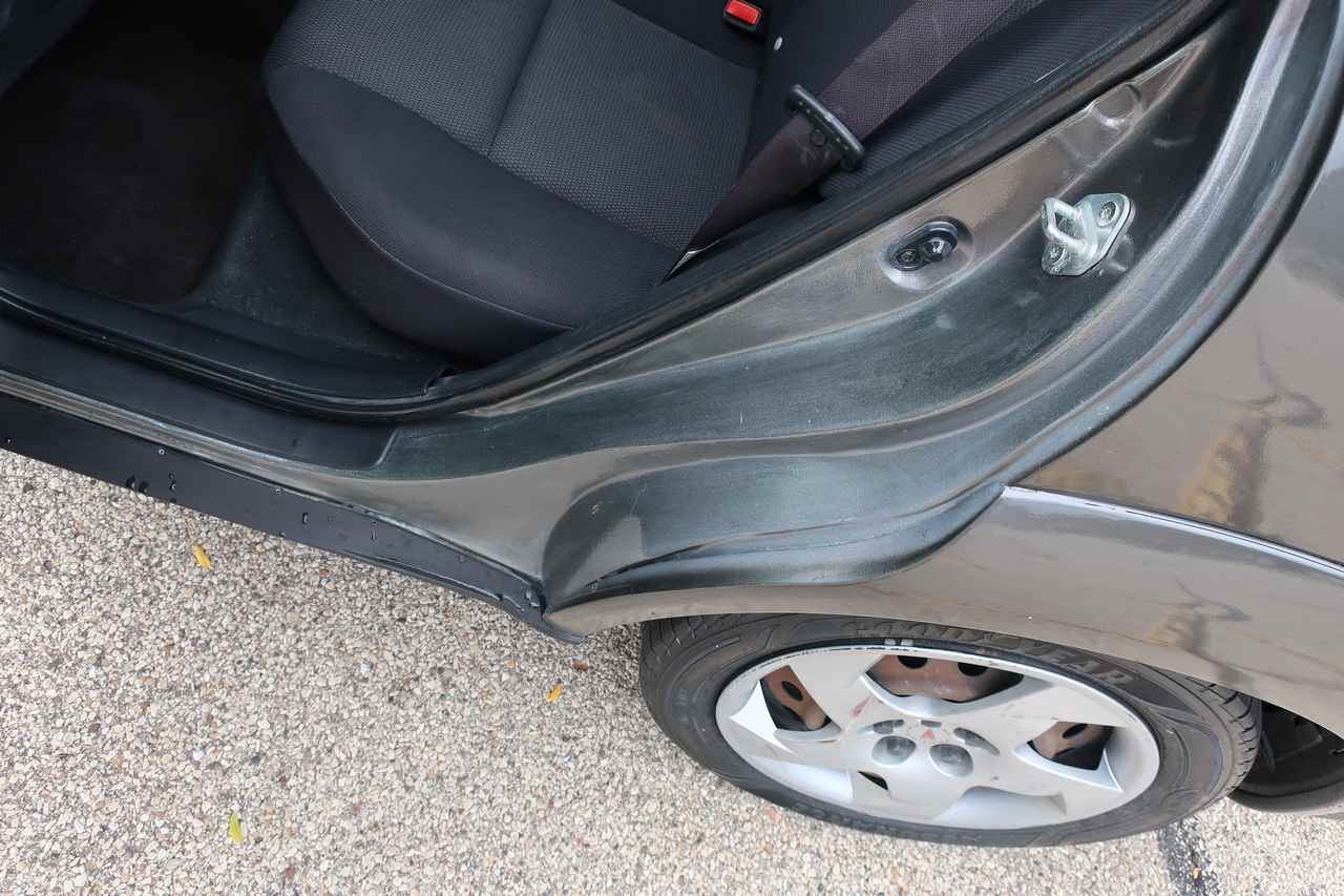

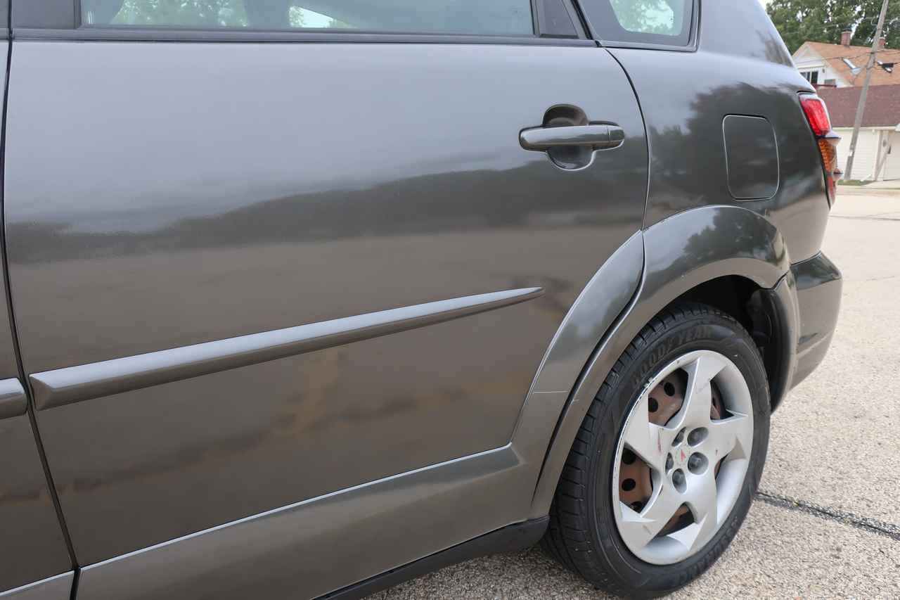

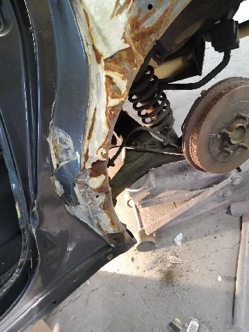

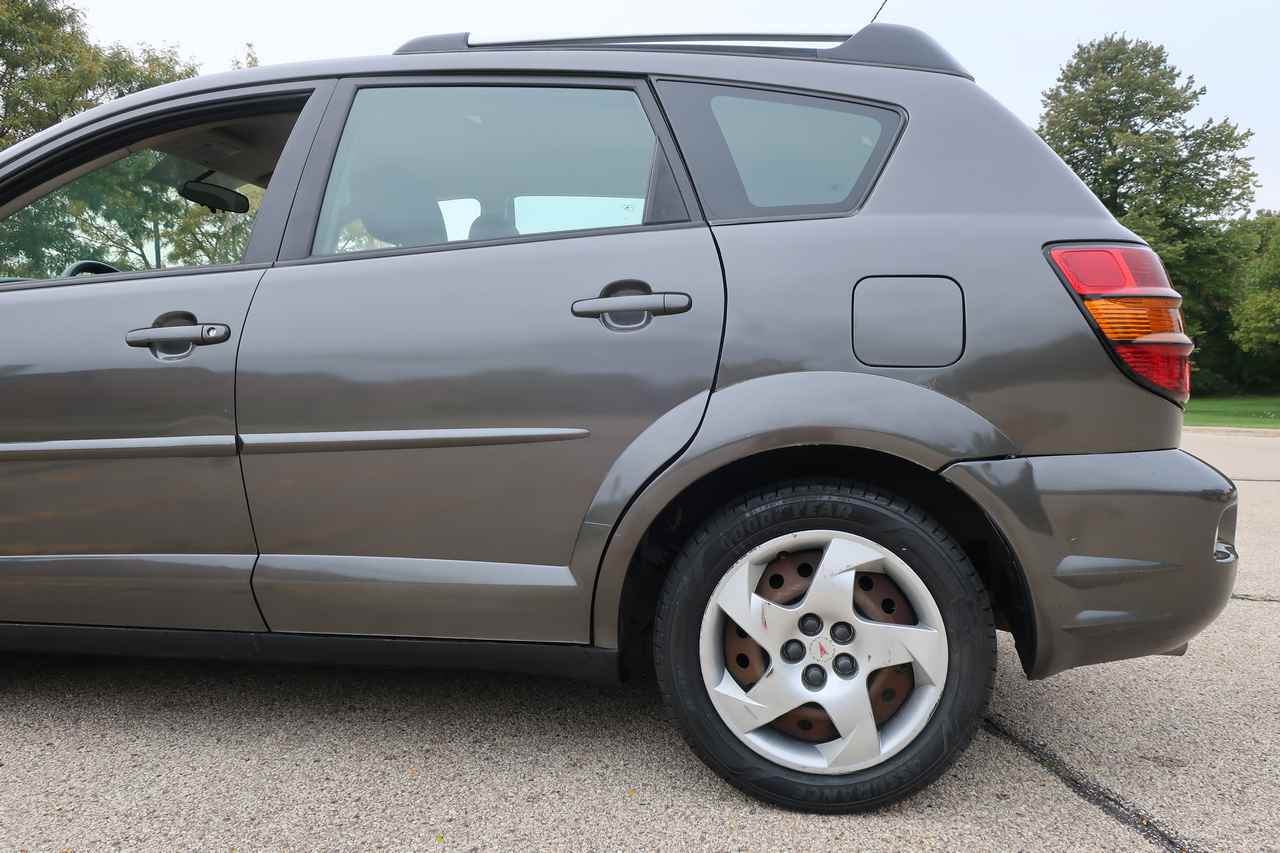

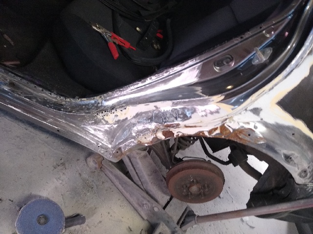

I forgot to post how this turned out. I ended up doing a version of what pwyu1969 suggested, except I found a retired body shop guy through Craigslist who does bodywork out of his home garage and he did the whole repair.
I told him my goal was to have the car look respectable, with a working rear door, and be safe to drive and that I was not looking for a Concours d'Elegance trophy-winning restoration. He charged $2200. The car looks good, the door works, and there are no driveability issues. It has gone through one winter with salted roads and so far, no rust. Photos of the repair in progress and the finished repair below.

Not bad BUT not the greatest either. The main thing was that you got it fixed and are able to keep this Vibe rolling along. You patronized a retiree (good as I'm right around the corner myself and will be doing occasional side work) and got your Vibe fixed. Thanks for the update ;)

Looks to me like you came out ahead moneywise and the retiree did a pretty good job - not perfect, for sure, but good enough - and you still have the Vibe you wanted to keep. You made the right decision.

The gentleman who did the repair originally intended to cut the damaged quarter panel from my car and replace it with a quarter panel from a donor car, but due to a miscommunication between us, he instead pulled the damaged metal back into position, covered it with mar-glass, then filler. It looks good to me. I will be satisfied if the repair lasts three years.
