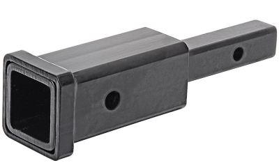

Using an adapter to expand a 1-1/4 hitch to accept a 2 inch hitch adds length to the arm of the hitch, this extension acts as a weight multiplier
kinda like the difference between picking up a gallon of milk vs. picking it from a distance using a broom handle

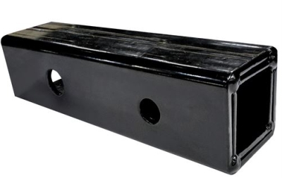

I did find two ramped chair carriers that might work, but they are pricey compared to other 2" only carriers, at https://www.prolineracks.com/wheelchair ... racks.html The description for two of them says " Fits 1.25" & 2" hitch receivers with included adapter sleeve"
I have no way to verify this, but since they use the term "adapter sleeve", it makes me think that the carrier normally fits a 1-1/4 hitch, but if you have a 2" hitch, you can use a sleeve that fits over the carrier to pad it out to 2", something like this pic
If that's true, then the carriers would plug in fine to a 1-1/4" receiver
