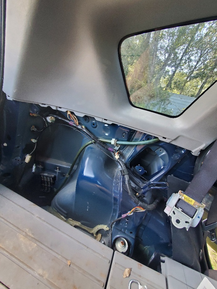

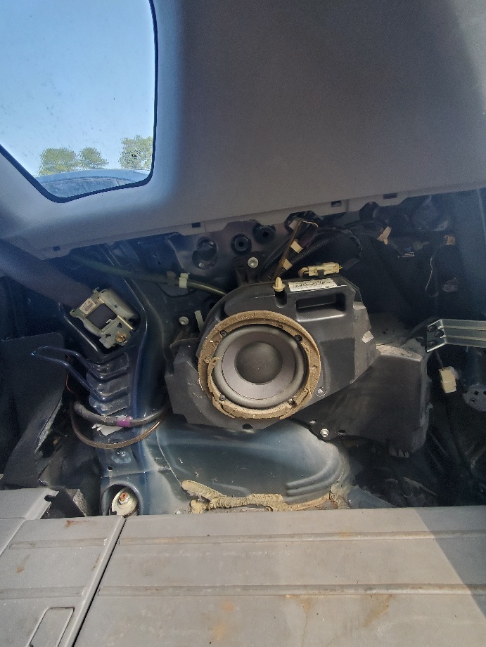

While I was at a junkyard the other day for some other parts I found a 2005 moon and tunes vibes and I pulled it apart in the back to look for this keyless entry module and i found nothing besides some seatbelts, a subwoofer, and the gas refill entry, i didn't find anything besides those. So I do not believe the module is behind the cargo interior panels in my year vibe.

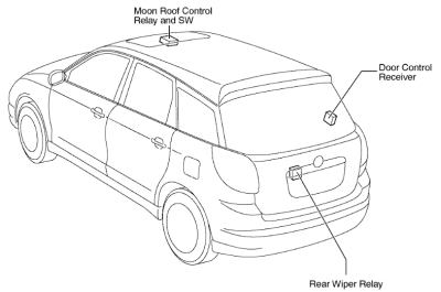

One of those sources was the 03 Matrix service manual, which shows the receiver location in this pic
I can't find any definitive source for the location in a Vibe or Matrix, but given the similarity to other Toyota products, there is this youtube video for an 03-08 Corolla
https://www.youtube.com/watch?v=Sf_SaOyGAGU
If its in the same place, then that would put it behind the trim panel above the one that you removed at the junkyard.

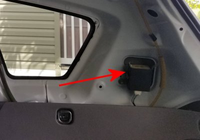

While typing this, I had an idea, and checked:
In viewtopic.php?f=28&t=47447 crispbacon posted a number of excellent photos of his Vibe interior with the trim removed. I grabbed one of them, cropped it, resized it and drew an arrow to what I'd wager is the receiver.

In http://forums.genvibe.com/phpBB3/viewto ... 28&t=47447 crispbacon posted a number of excellent photos of his Vibe interior with the trim removed. I grabbed one of them, cropped it, resized it and drew an arrow to what I'd wager is the receiver.
I got one from a junkyard a while ago from the location you showed in the picture and I took the entire inside of my car apart to do some work and replaced the part and it fixed the issue, I had to get a new fob like a few days after though for some reason it was weird idk if it didn't like the new module or something 😂😂 but my receiver finally receives now
