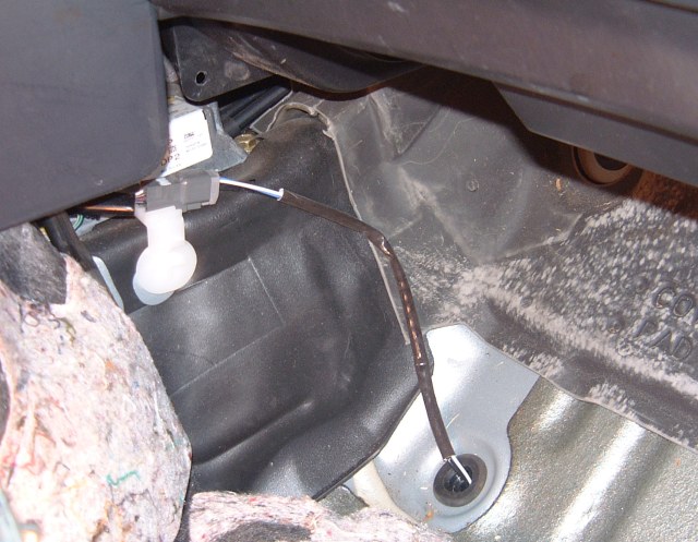

I've replaced the one after the cat, I disconnected the connector inside the car (on the left side of the front passenger footwell)
then pulled the rubber grommet and wire through the floor, and threaded a box end wrench over the wire to get to the sensor. Looking at an old thread I used a 7/8" box wrench, that's pretty close to 22mm.
If I remember right, it took some force to get it started
