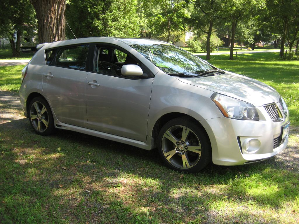

I've been meaning to post an update for quite a while, but just didn't get to it. My engine replacement project went pretty well. I ended up crossing my fingers and buying one of the JDM motors. I was reluctant to do that because of the unknown history, but it seems to have worked out ok. I had to replace the timing chain cover with the original because of differences in the motor mount boss. That meant replacing the crank seal and valve cover gasket too. While I had things apart, I had the flywheel turned and put in a new clutch.
When everything was back together and all the fluids filled she fired right up even on the old gas in the tank. Because of the Covid issues, I haven't been able to get current tabs for it yet, but I have been driving it a little.
