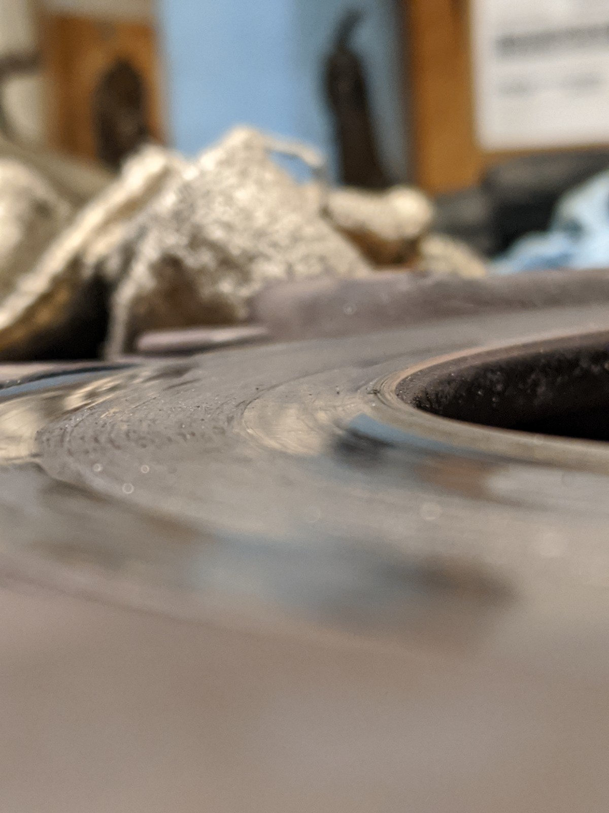

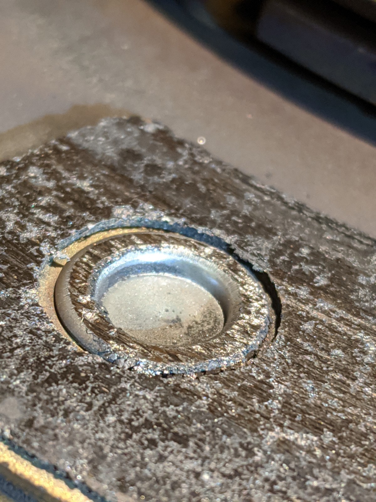

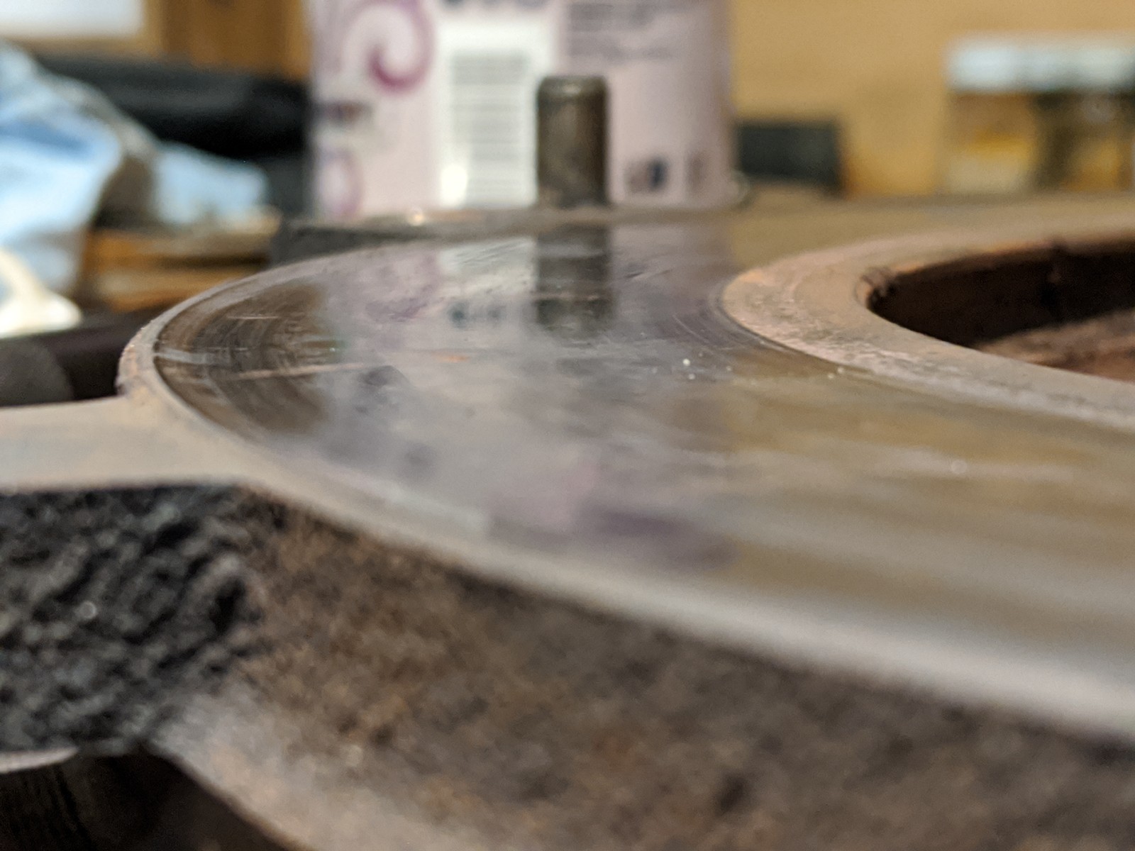

Time for some investigation!

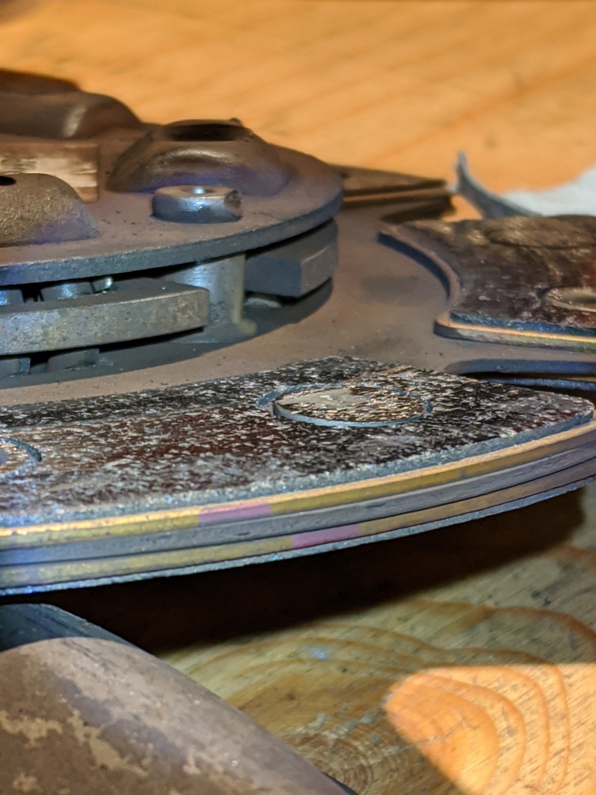

Well, these are some well worn components.
As they say, "Well, there's your problem."
So a few things interesting here, obviously someone has put a non OEM clutch in the car, which sounds like a pretty normal thing due to the power output of the 2ZZ. What they unfortunately also did was adjust the clutch master cylinder to have just a little bit of pressure on the system at all times (please don't do this), which I believe caused the TO bearing to ride on the pressure plate fingers all of the time, wearing the groove as shown and applying pressure to the fingers just enough to cause the disk to slip every so slightly and absolutely destroy the flywheel and pressure plate. I don't know if I've ever seen a setup worn so much in my time working on cars.
Thankfully, you can buy a new flywheel for less than 75$.

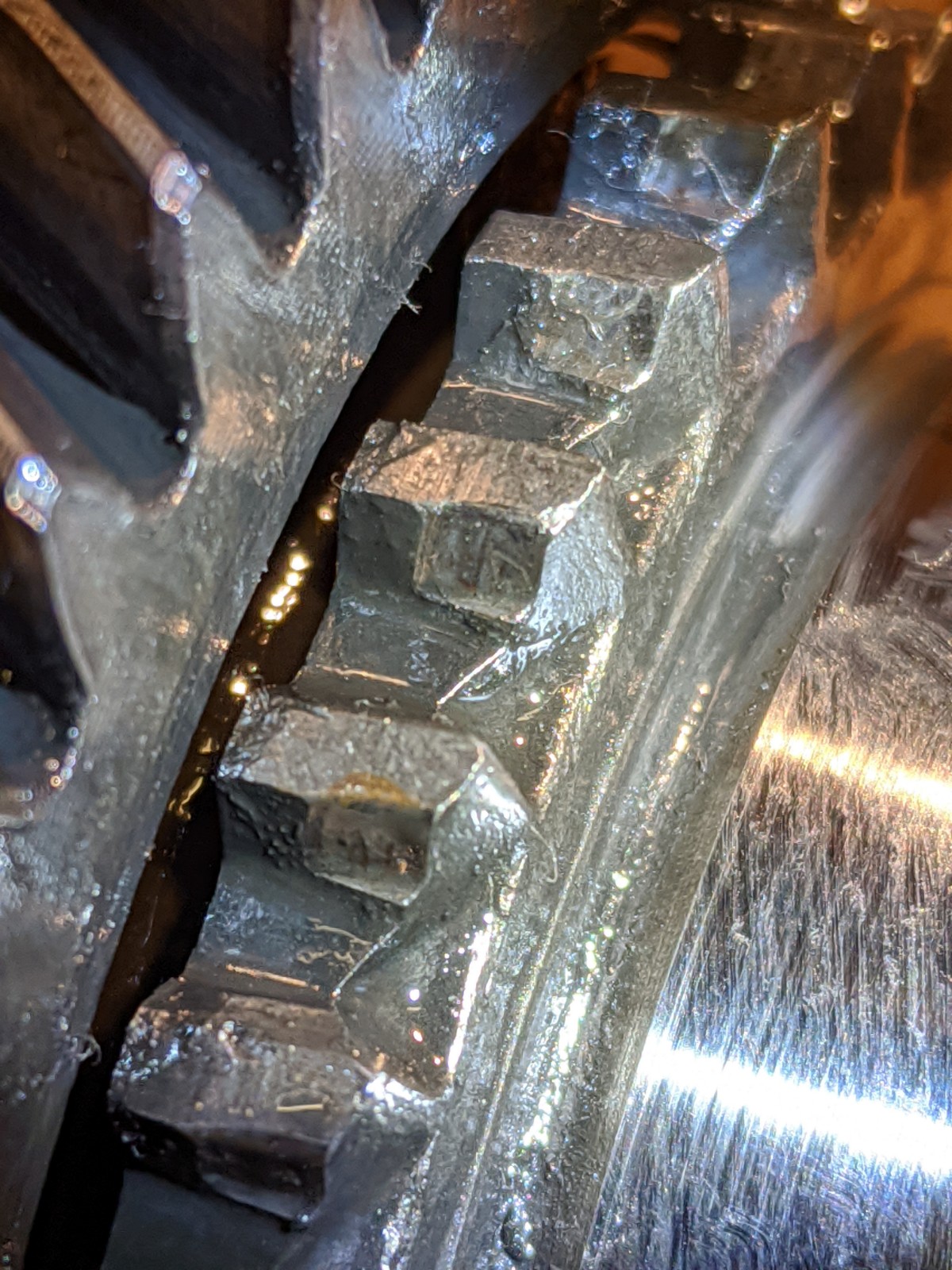

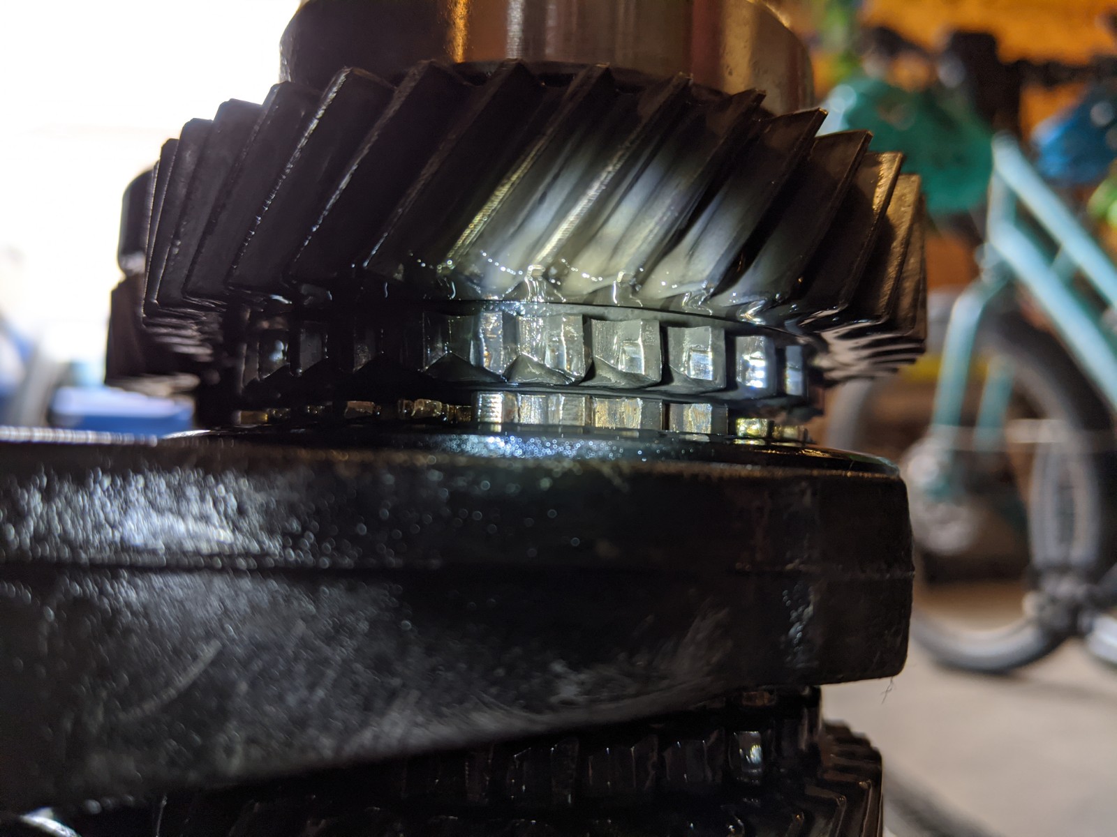

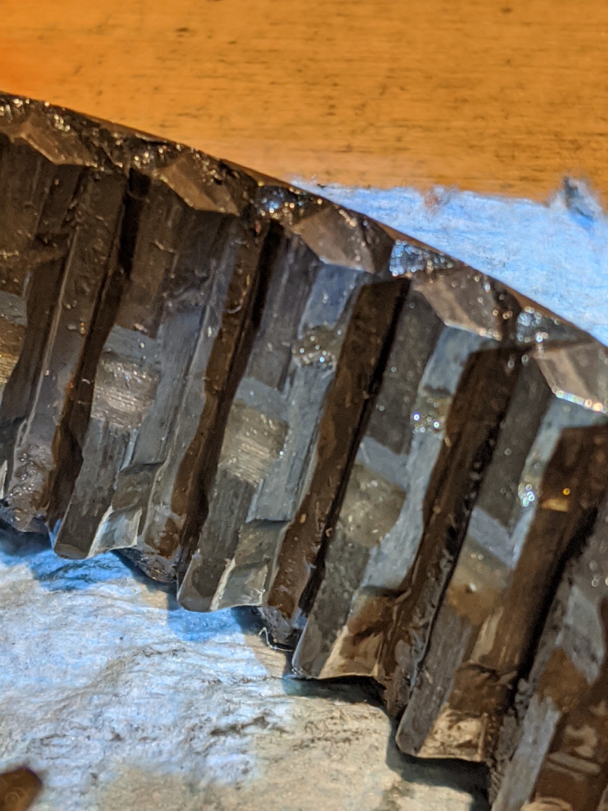

Okay, with those parts headed my way, time to check out the 6th gear issue.
Originally, I said to myself, "Oh I'll change the fluid and see if that fixes it and tackle the 6th gear later." After evaluating re-installation of the transmission and then possibly having to take it back out for another repair immediately, I knew I was going to fix it right the first time. Luckily, 5/6 can be accessed by pulling the end cap off the case.
And what did I find? Just what you'd expect in a Toyota transmission with a gear that pops out. Worn parts. In this case, I could engage the 6th gear by hand, and just by applying human torque it wanted to pop out of 6th gear.
Off to the Toyota parts catalog I go. A new 6th gear, 6th gear driven, 5/6 hub ring, and 6th gear syncro (probably what caused the problem originally), ordered up from a pal at Toyota and now I just get to wait and clean things up.

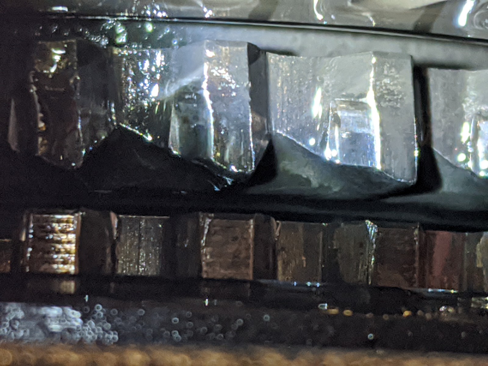

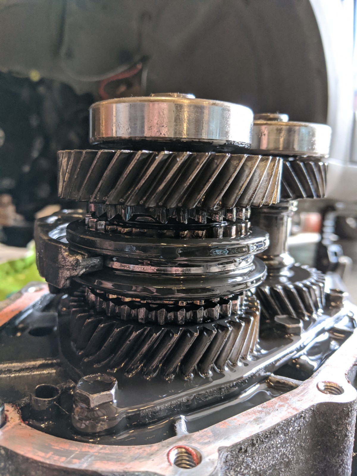

Seems like I can only add five photos at a time to a post. So here is the one showing the worn transmission bits!

All that's left is to reinstall some new stuff and throw that transmission back in there. Should be easy right? Installation is reverse of removal!
First, let's install those shiny Toyota bits so we can get back to 6th gear cruising. Went back together easy enough, don't tell Toyota I installed these gears and their bearings with a block of wood and a hammer please.

sclay115, good write up and progress on the repairs. Popping out of gear is most always a syncro problem. Seen this many time on pickups with manual transmissions that are used for snow plowing. The strange thing is that it was sixth gear. It is usually second gear, with people thinking they are speed racer, that runes a syncro. The pressure plate fingers that are worn do not look that strange. I have seen them turn blue from heat and worn almost through from a bad throwout bearings. People that tend to rest their foot on the pedal while driving are the ones that have throwout bearing problems that lead to high pressure plate and clutch disc wear. More people do this then you think, and after spending enough money on clutches, these drivers switch to automatic transmissions. Nice that it all come together for you. Some times it is best to retreat, gather your thoughts, and then attack it again.
