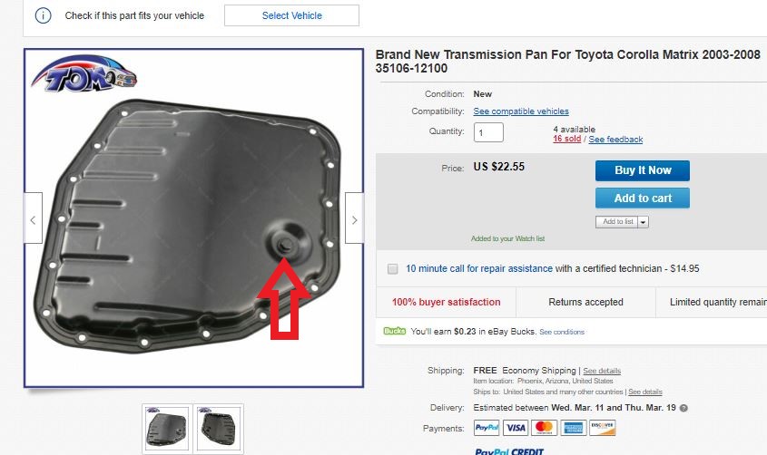

Thanks for the help, guys. So, the 35106-12100 part number is for the regular front wheel drive...and the Matrix, Corolla, and Vibe are all the same? I found one on Ebay for $20! And it looks like it comes with the right length screw too:
And, if my original post was hard to understand: bolt is totally ruined. I bought an appx 1 1/4" long bolt and put about 1/2" of washers on it and got it to stay in place and not leak. The nut that it screws into is in fair shape so maybe I don't absolutely need to replace it, but I really should.

I'm just not sure what nut you're referring too, as the transmission pan and drain plug do not have any nuts on them....
If you are referring to the drain plug, which I have put a red arrow pointing to, you can replace JUST this plug. It is a $5 part at your parts store. Unless you totally screwed the threads up on the trans pan that this drain plug goes into, just do the plug and call it a day.

Fwiw, the torque for the transmission drain plug is only 13 ft. lbs. (This is ~1/2 of what the oil drain plug is.)
I suspect that is why some are stripped that tranny plug.

So, a screw or a bolt is the male end. A hole or a nut is female. The transmission pan either has a nut welded to it, or you're actually screwing into the pan itself. Either way, the threads on that female hole/nut/pan itself, are stripped.
