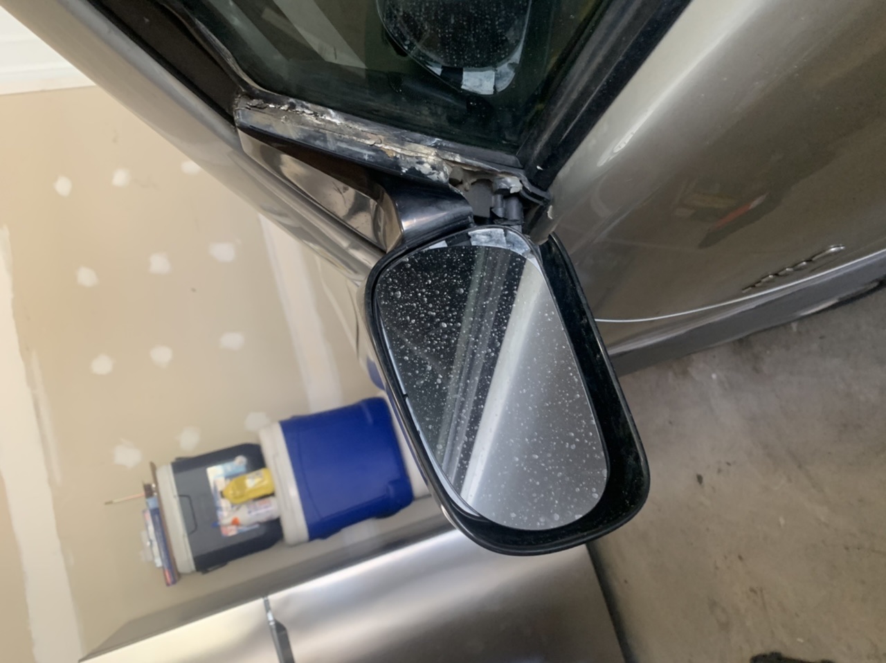

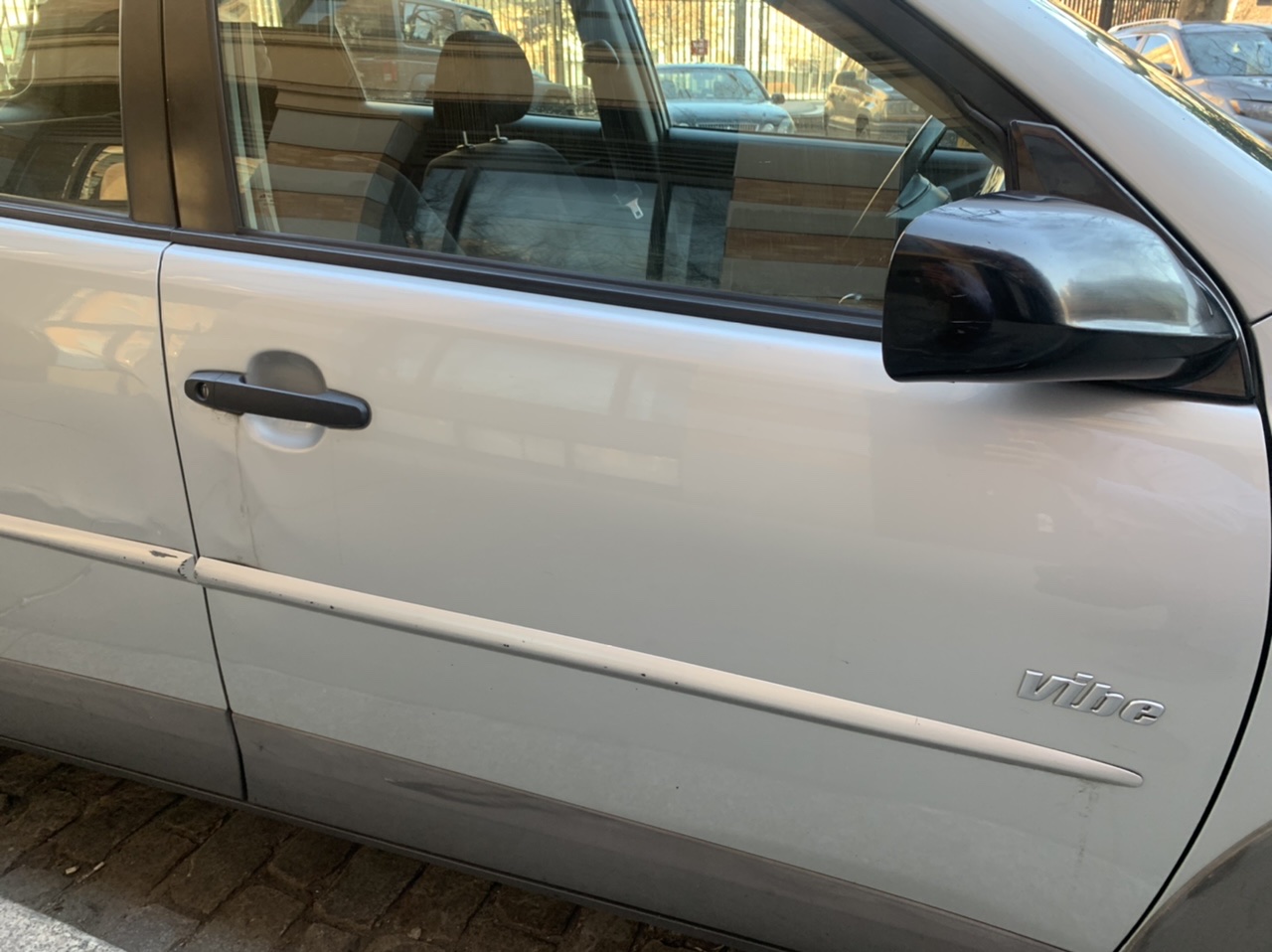

I’ll start with the driver side mirror. This car has working automatic mirrors, but the driver side one was in rough (though functioning) shape. The junk yard I went to had an ‘04 Matrix with manual mirrors. I figured the cover was the same and assumed the mirror glass would switch over as well. Turns out the cover is an exact match, but the glass has a different backing that won’t attach to the automatic mechanism. I swapped the cover, and some hardware that was rusty. I’ll be on the hunt for an automatic mirror glass, but it’s fine for now.

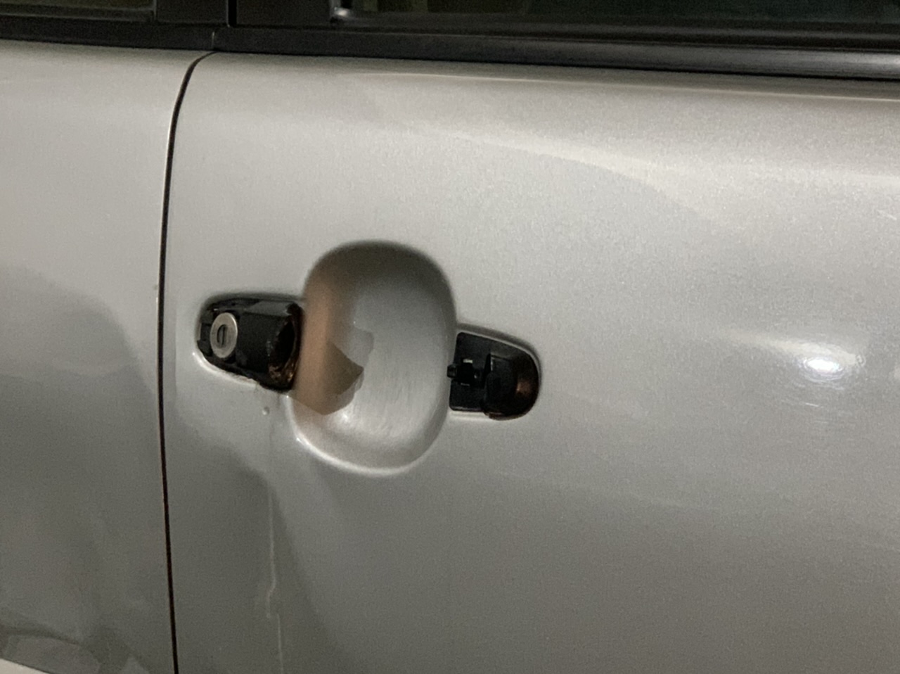

I swapped out the passenger front door handle for one from the same Matrix. Luckily the internals were fine, so I only had to remove the lock to remove the broken bits and insert the good one.

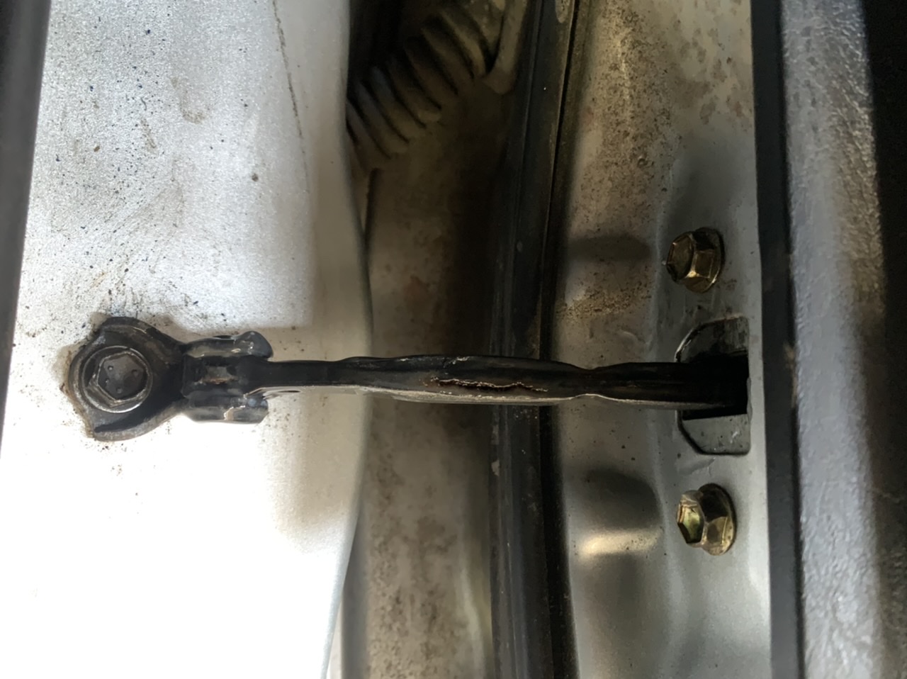

The driver side door check was swapped at the same time I worked on the mirror. It’s just three 10mm bolts, but they have thread locker, so I suggest an impact. I used the one I took off of the Matrix, but it doesn’t work perfectly. I probably should have sprung for a new one, if you need to replace your door check I don’t suggest a used one.

Re: Repair Log “Silver Bullet”
With the door check, is it catching the window now? If so, the fix is to grind a corner off of the strap so it clears the window when it rolls down.
Otherwise, so far what you've done is pretty common to all of them at this age.

zbyers wrote: Mon Feb 17, 2020 4:31 am With the door check, is it catching the window now? If so, the fix is to grind a corner off of the strap so it clears the window when it rolls down.
Is that what the window clicking on the way down is????? I thought I had put the door trim in wrong and was gonna try to redo it this week haha. How much should I trim? Is that due to using the matrix door check?

FrankenVibe wrote: Mon Feb 17, 2020 4:54 am
yep, that's probably what it is. be careful, as it can cause the glass to shatter. other members were saying they trimmed about 3/4" off the corner on the window side, and the smoothed out the points.
viewtopic.php?t=31218

zbyers wrote: Mon Feb 17, 2020 5:17 am yep, that's probably what it is. be careful, as it can cause the glass to shatter. other members were saying they trimmed about 3/4" off the corner on the window side, and the smoothed out the points.
Thanks for the info and link. Wish the photos in the first post were still there, but I get the gist haha. I could perhaps bend the door back into shape with some wood and hammering, but I would trim the door check while I’m in there anyway.
