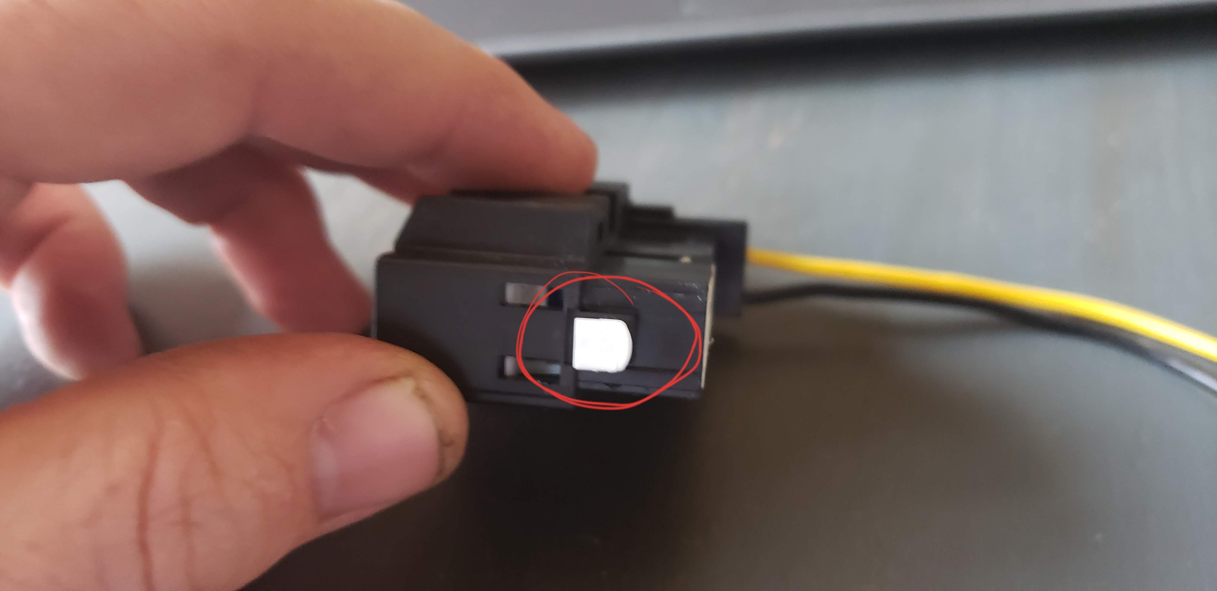

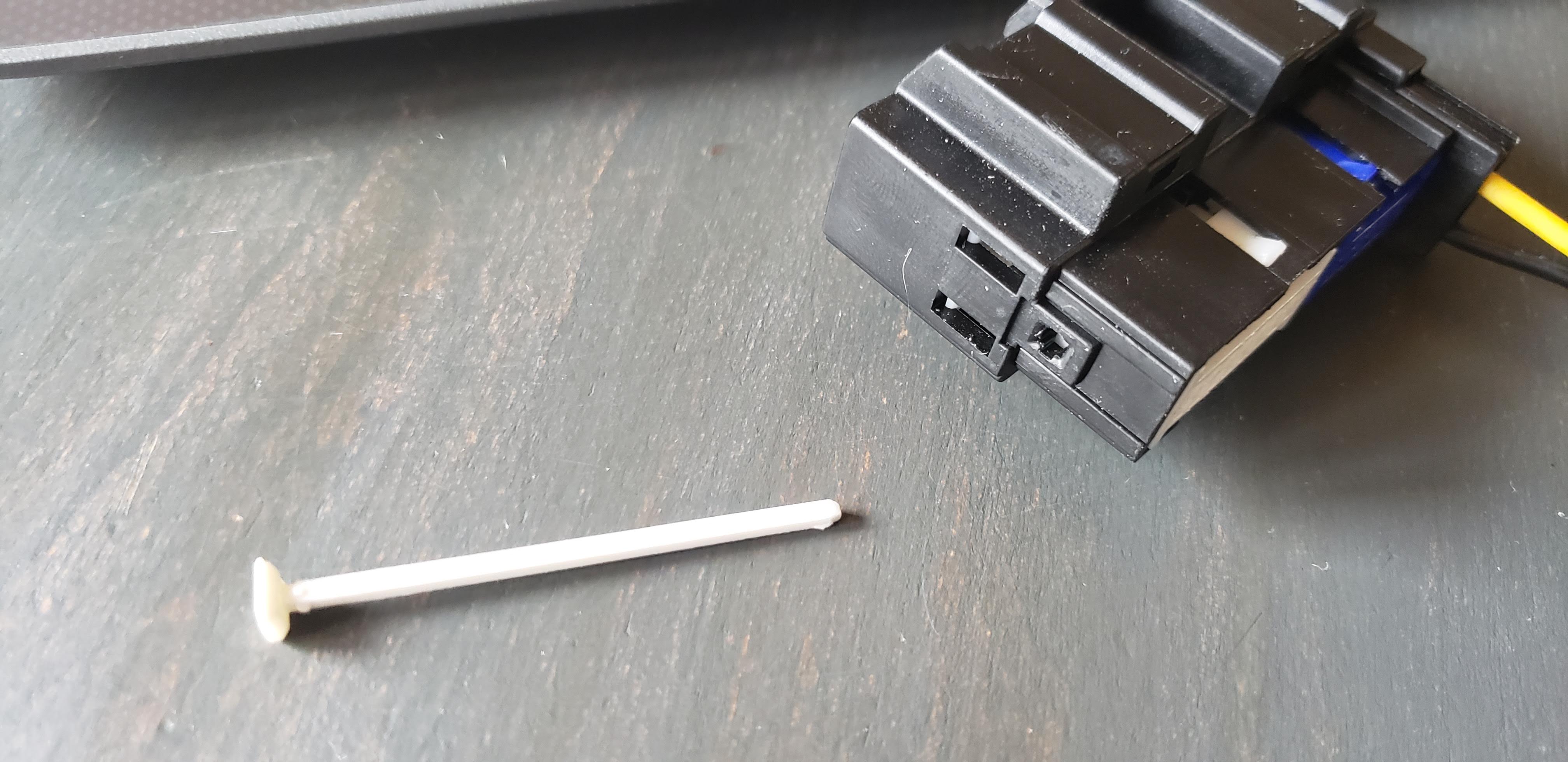

To pull the pins the first thing you need to do remove the white plastic pin on the side of the harness. Be careful when removing this because the top of it will break off and you will not be able to remove it. I recommend getting under two sides of it and pulling evenly rather than prying it out.

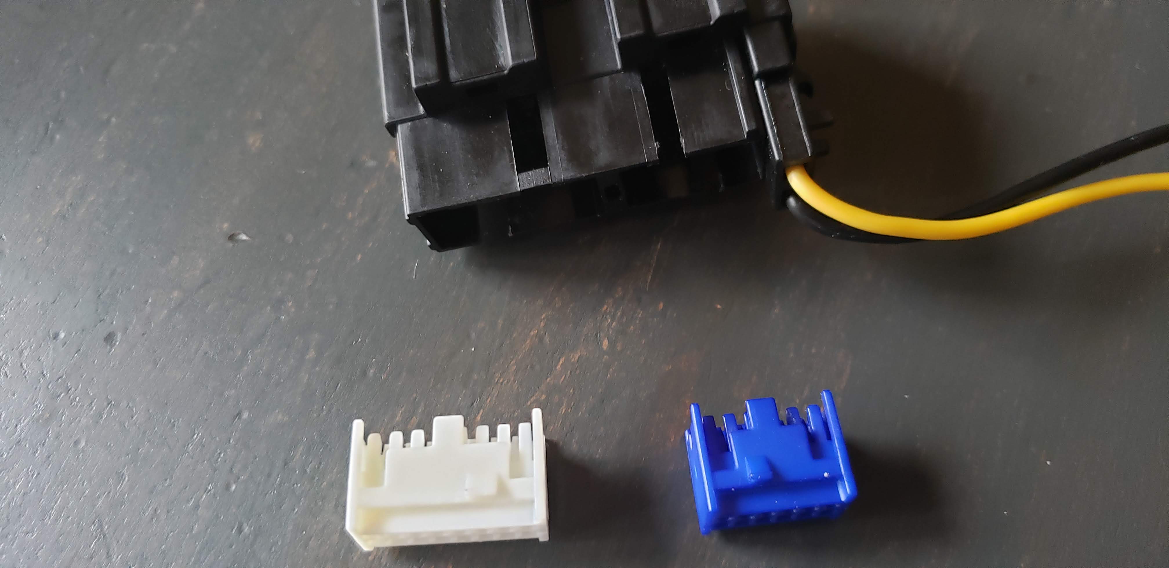

Once the Long white plastic pin is removed you can remove both the white and blue clips that hold the pins. Be extremely careful from here as the pins break easily and this is why I ended up buying 3 wire harnesses.

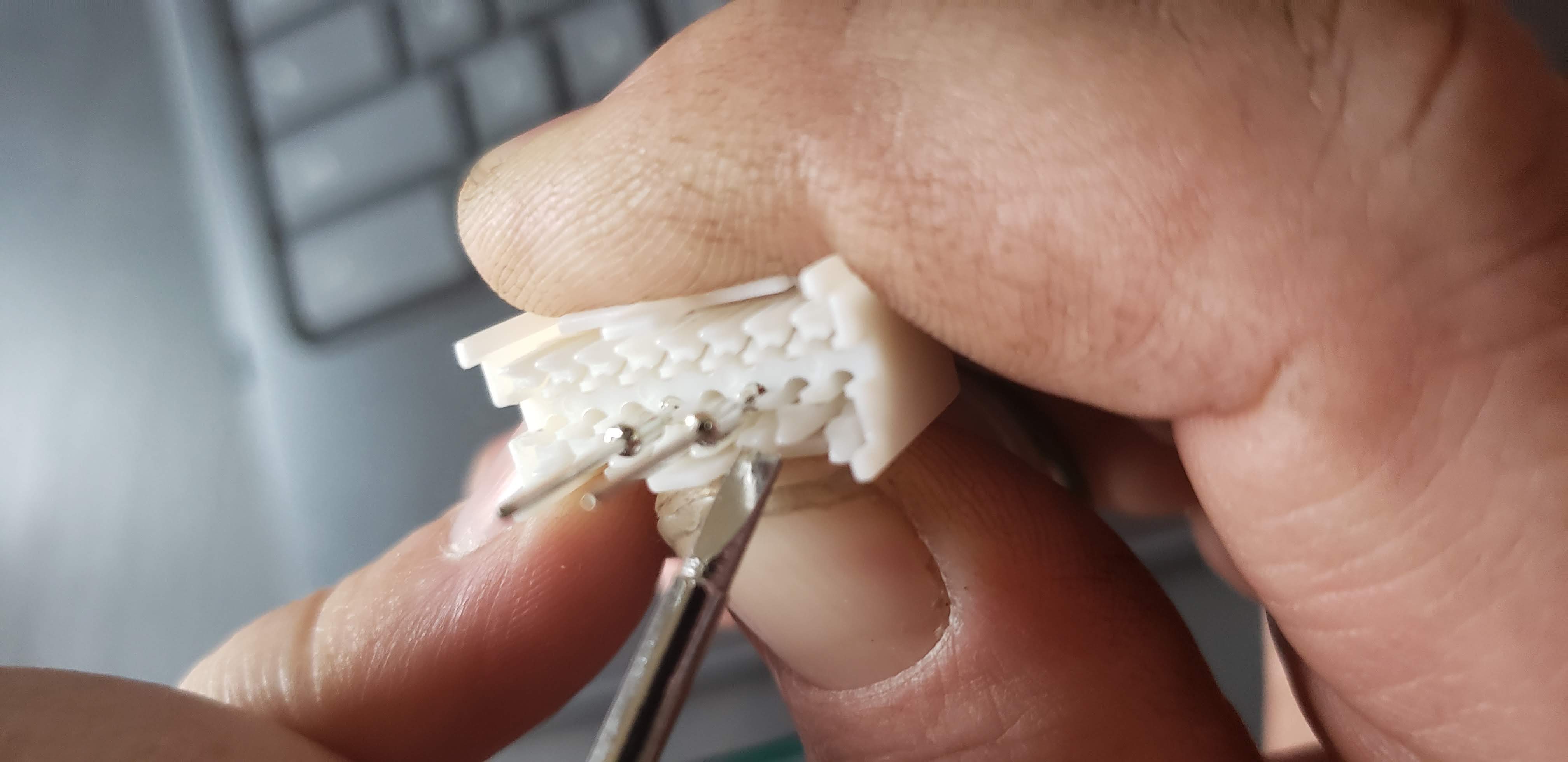

After you get the white and blue plastic wire clips out remove the pinned wires by using a small flat head screwdriver or something similar to push back the plastic clip that is holding the wire in and pull firmly but evenly on the back of the wire and it should slide right out

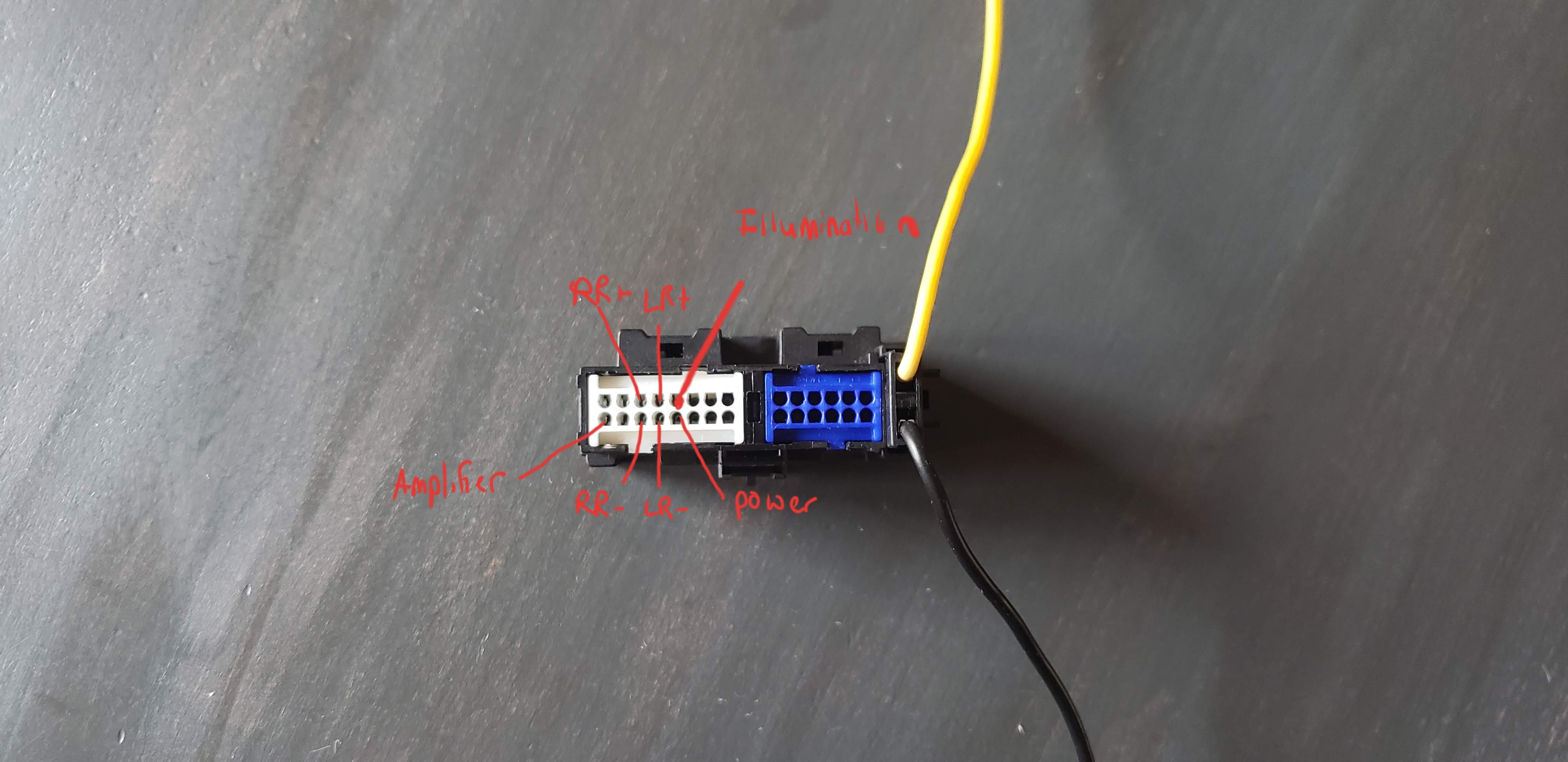

This is how I placed the wires back into the harness to have everything connected. I left the Constant and ground wires in since they are the same. These pictures show the back side of the wiring harness that will face away from the wires in the car. Once you get it all wired if it still isn't working make sure you check your radio fuses both in cab and under the hood.
16 pin white connector from left to right
Top
1 empty
2 empty
3 Right rear positive
4 Left rear positive
5 illumination
6 empty
7 empty
8 empty
Bottom
9 Amp
10 empty
11 Right rear negative
12 Left rear negative
13 power
14 empty
15 empty
16 empty
14 pin blue connector left to right
Top
1 Dimmer
2 Antenna
3 Steering wheel control 1
4 Steering wheel control 2
5 Right front positive
6 Left front positive
7 Constant
Bottom
8 empty
9 empty
10 Steering wheel control ground
11 empty
12 Right front negative
13 Left front negative
14 Ground
I do believe that I need to figure out a drain wire still since I hear an electrical hum every once in a while though.
