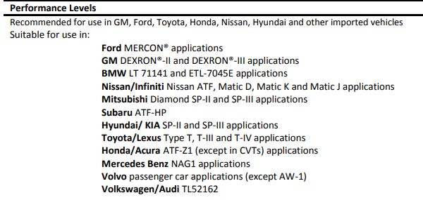

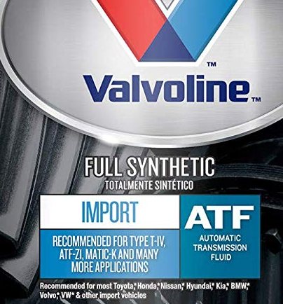

Which fluid is the BEST to use? I'm assuming I want full synthetic. Car will get 25,000 miles per year. The T-IV is old and not even synthetic, although I've seen that it's a synthetic blend (same as Mobil JWS3309). Any Dexron is a no-no. I don't want MaxLife with its more aggressive seal conditioners because as of now there are no leaks. Castrol Transmax is fully synthetic and supposedly works fine. A bit pricey locally, but I don't want to get it if it's not best for the vehicle.
Then, there's what I WANT to use. It doesn't seem to be too popular, but it's cheap, available and what I use for the older Camry: Valvoline Import Multi-Vehicle Automatic Transmission. It's says Toyota "Type IV" right on the front and I can get it locally $6/quart or $25/gallon. Fully synthetic and has kept the Camry going good from 200k to 350k. It says it's good for Dexron and many other applications though. Would this be the "best"?

I've used the Castrol Import (I think it's called. Basically same flavor as that Valvoline.

Upon inspection the transmission fluid was pretty brown. I thought it was red when we bought it, and maybe it was, but that was a year ago, and I haven't been the one driving it. And, I did end up using the blue Valvoline Multi-Vehicle Import stuff: a) been good in the Camry, b) can buy for $6 locally or $24 locally for the big jug, c) says "Toyota Type IV" right on it.

I like to stay with Toyota Type IV fluid myself but would also consider the Valvoline or Castro Multi Import. I personally would not use the Valvoline MaxLife. MaxLife is LV and “a one size fits all”. I was concerned with the 5.9 csT when the Toyota is just above 7. It's probably no big deal and I know many have been using MaxLife but I am happy staying with the Type IV.
