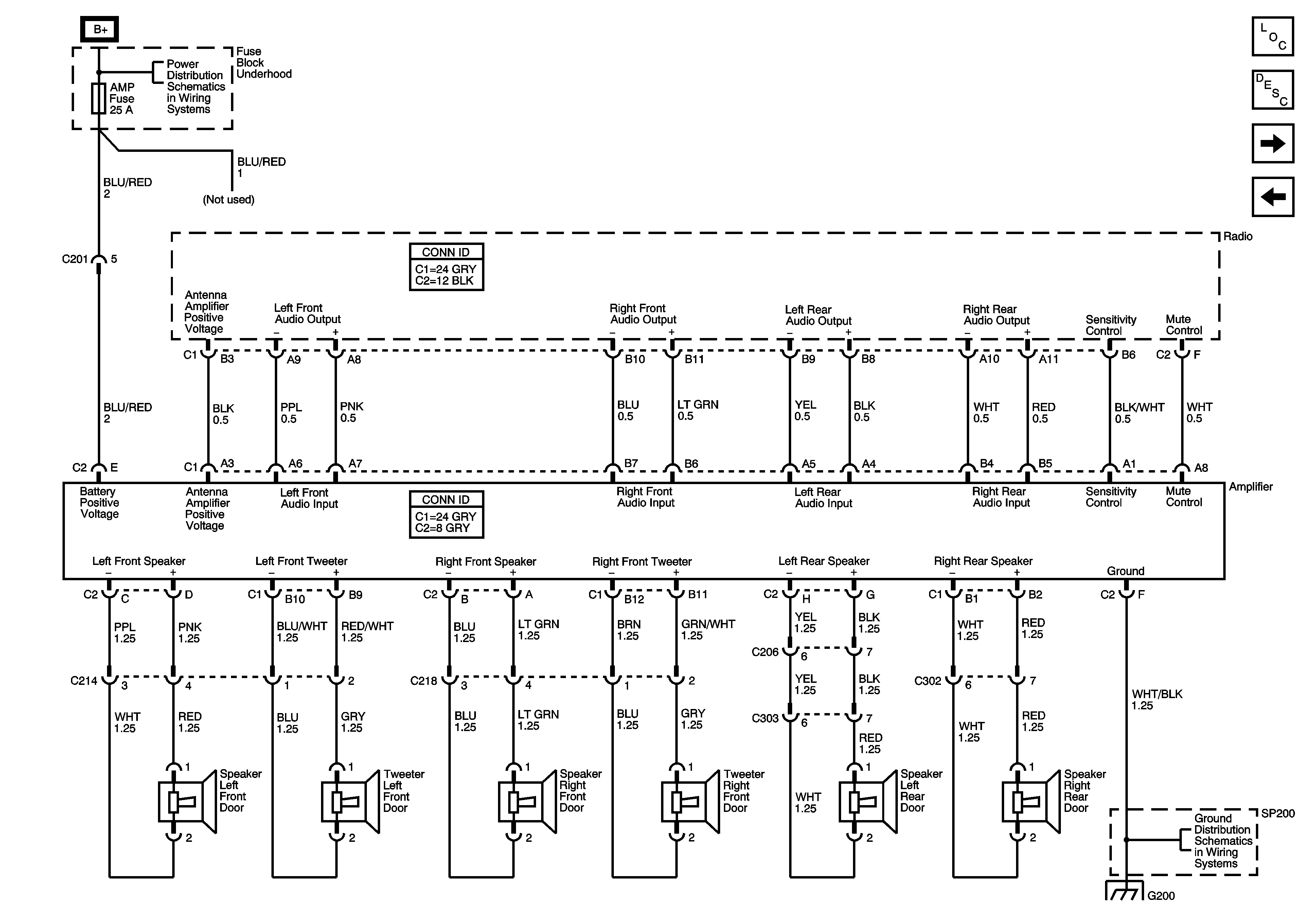

Can someone give me suggestions for what to test? I assume it’s not the head unit (original).. maybe some connectors? Isn’t there an amp under the front passenger seat? I don’t have a wiring diagram, don’t know if there are crossovers like in a home speaker, or how it’s set up at all. Any suggestions appreciated.

Does anyone have the wiring diagram for moon and tunes or is familiar with the difference between base sound and moon and tunes? The base case electrical diagram is in the Haynes book, but that is of limited use. I guess I'll poke around under the passenger seat this weekend.

Anyway, I saw some posts of folks who had speaker issues and some videos on YouTube. It may well be deterioration. But I wouldn't rule out the radio or the amp. The posts by Derf no longer come up with the schematic. Looking under the seat isn't very enlightening.. I wish there was an easy way to test. The only thing I could think of was to try the working speaker connected to the other channels to test the amp, but the harness connector being what it is, this would be hard without cutting wires. I have no oscilloscope. Swapping around the speaker itself seems a hassle since the door trim would have to come off and the speaker is riveted in.

You don't need this anymore,but since its missing from other posts, here's a diagram showing the wiring between the head unit , the amp and the speakers in an 03 M&T There are no crossovers, at least not external to the amp.
