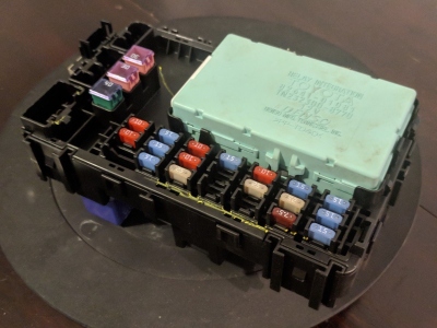

There is a schematic for the interior lights of an 03 Matrix at download/file.php?id=2079 It should be almost the same as in your 06 Vibe, except that in the 03, the dimmer switch also had the door/on control for the dome lights built into it, where on your 06 that switch is part of the dome lights themselves.
In both cases, the dome lights get +12V from the dome fuse. When set to on, the lights get ground directly from a tie to ground. When set to dome, the lights get a ground from something GM calls the "integration relay", which is the light colored plastic box on the under dash fuse block. (light blue in this picture)
I don't know what's inside that integration relay box, but its more than just a hard relay to ground, because if you have power doors/locks, its the integration relay that slowly ramps up from ground to give you the dome light fade effect.
