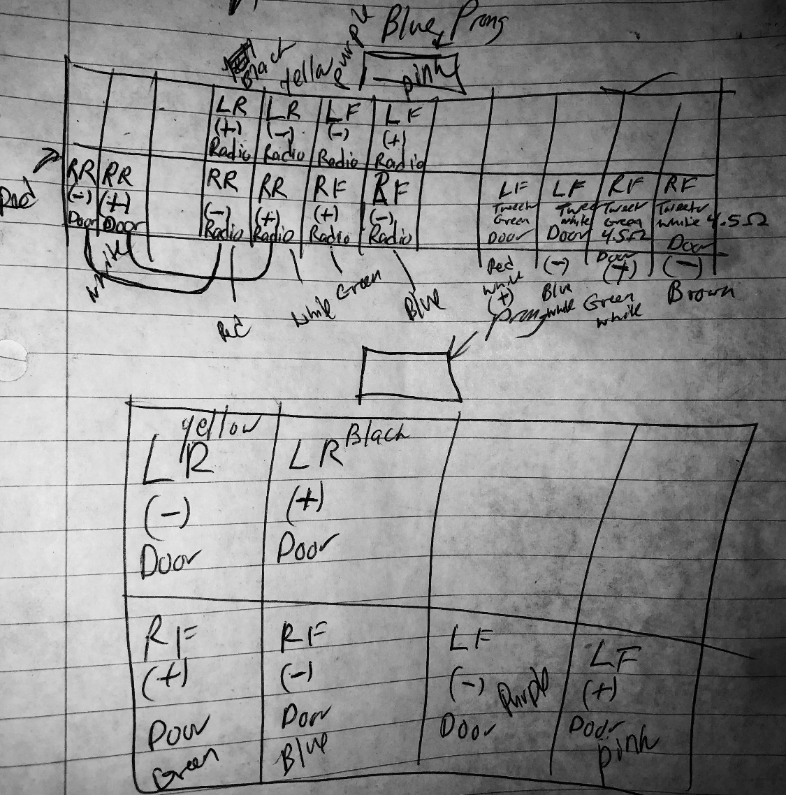

This is for your information. I could not find a diagram like this so I pulled the doors off one by one and chased the wires down through continuity. I did the same to the back of the stereo. This helps with the hum or whine or whining that happens with these after an aftermarket stereo is installed. I did not find a single harness adapter for this model and I spent hours trying to create a harness before I decided to cut one at a time and (removed) connect them together.
Please forgive my drawing. I’m not exactly artistic. 😝
