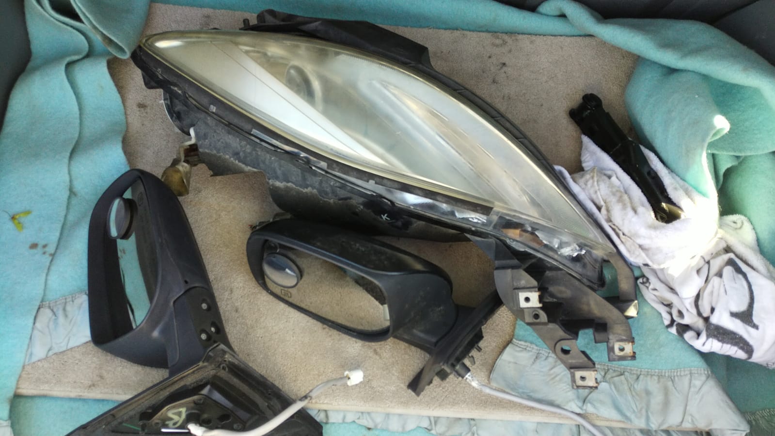

Went to local junkyard since it is nice weather, for me it is a candy store. got a pair of heated mirror from CDN matrix with 4 wires into the plug. I hope it is a simple plug and play. I will let you folks posted.
Trix Mirror and 09 Mzd 6 light housing
Trix mirror.jpg (155.46 KiB) Viewed 150904 times
When you go to cash and pull wrecker, in addition to your handy tool, bring a bottle of liquid wrench with you, learnt the hard way with removing the dumb ford engineered mazda 6. they use 3 differ bolt sizes at the front and many of them are rusted..

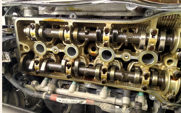

Just replaced my valve cover gasket, Valve Cover Gasket Set Mahle VS50362 MADE IN JAPAN, and they are identical to factory one ( with notches so the gasket dont hang down when you placing your valve cover back ) and half the price.

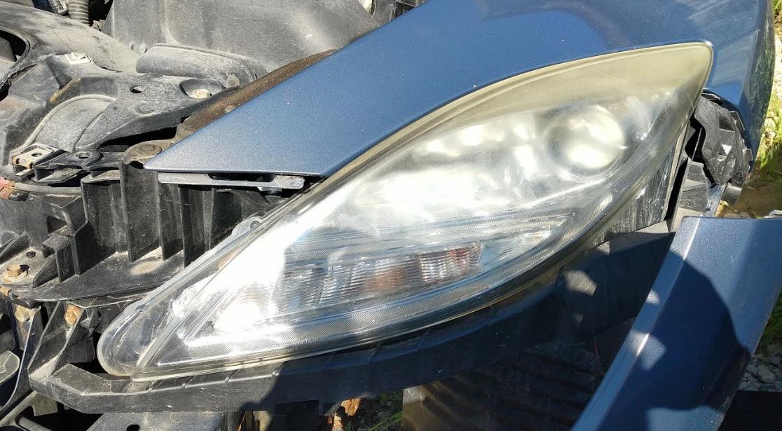

coated with Rustoleum Gloss Clear non yellowing UV resistant
Polished Headlight.JPG (137.42 KiB) Viewed 150747 times

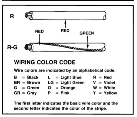

Yes you are right. I took the door panel out..the other end only have 3 pin so it is missing the 4 th heater power...so it is basically have to run another wire from there to the defrost relay. I have taken a lot of photo ...
Colour Code2.jpg (45.74 KiB) Viewed 150856 times

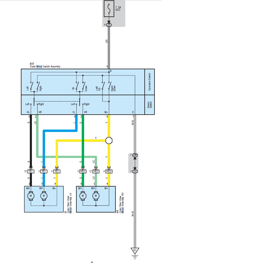

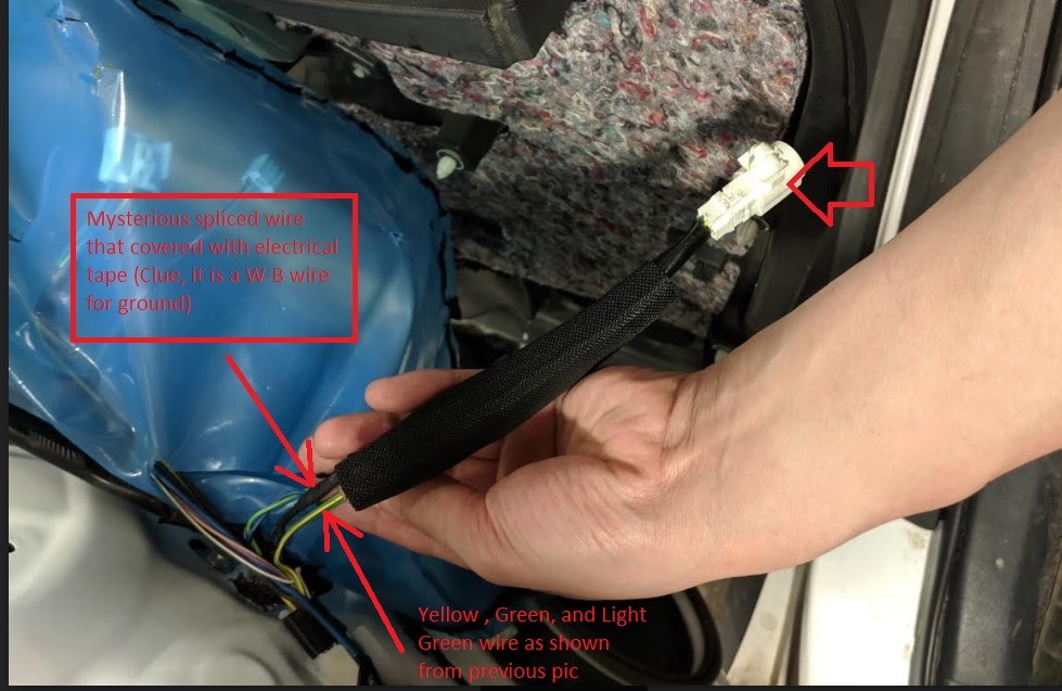

Actual vs diagram

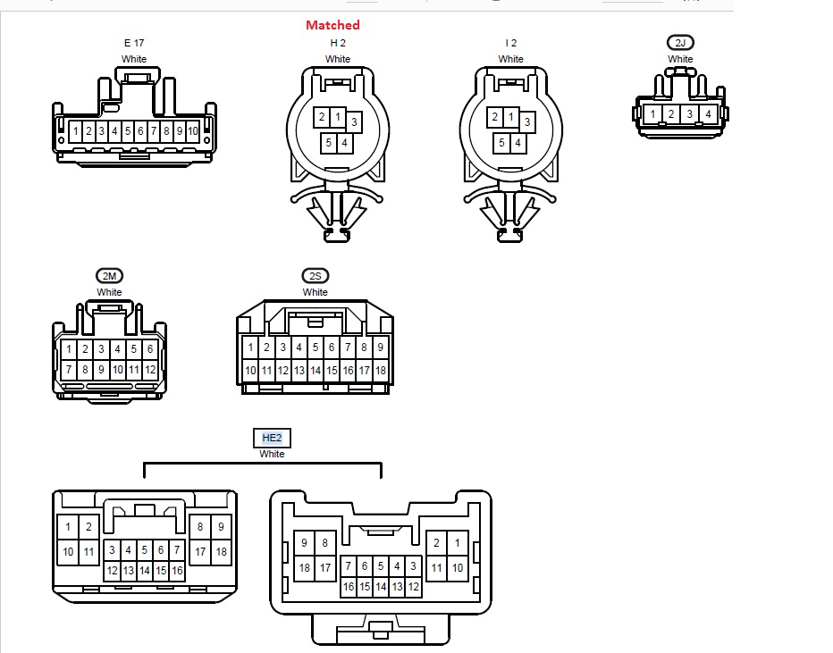

Link below also talks about different Molex connectors toyota uses.. it appear the connectors can be different shape that dependent on the connectors ( 8 pins.. 10 pins, they can be different) so have to pay attention on sourcing parts
https://blog.machanon.net/2013/05/13/di ... Qgcw3rPy72
the factory came with a mysterious splice wire
Shouded Cable.jpg (167.24 KiB) Viewed 150835 times

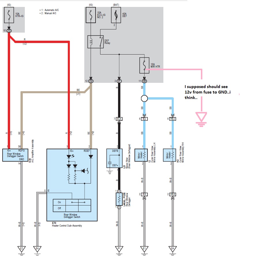

Heated Schematic.jpg (104.5 KiB) Viewed 150853 times
Connectors matched picture
Showing wire colour (G , Light Green & yellow)
Actual Vibe Wires.jpg (149.77 KiB) Viewed 150854 times
Mirror Control Diagram
Mirror CTRL Diagram.jpg (73.91 KiB) Viewed 150854 times

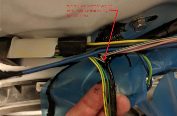

Neutral -ground wire
common ground.jpg (58.73 KiB) Viewed 150833 times
Reference website
https://www.tacomaworld.com/threads/hea ... vy.377840/
Also look at the common ground wire that terminated and bundled with my power mirror wires

Each connector per door
Door Main Connectors.jpg (96.71 KiB) Viewed 150793 times

Also confirmed from the HTR Mirror fuse that it does have 12V when enable rear defogger

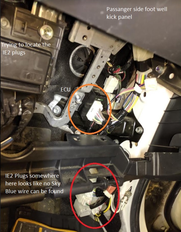

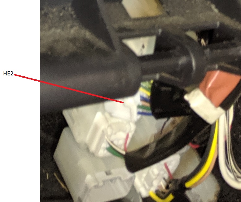

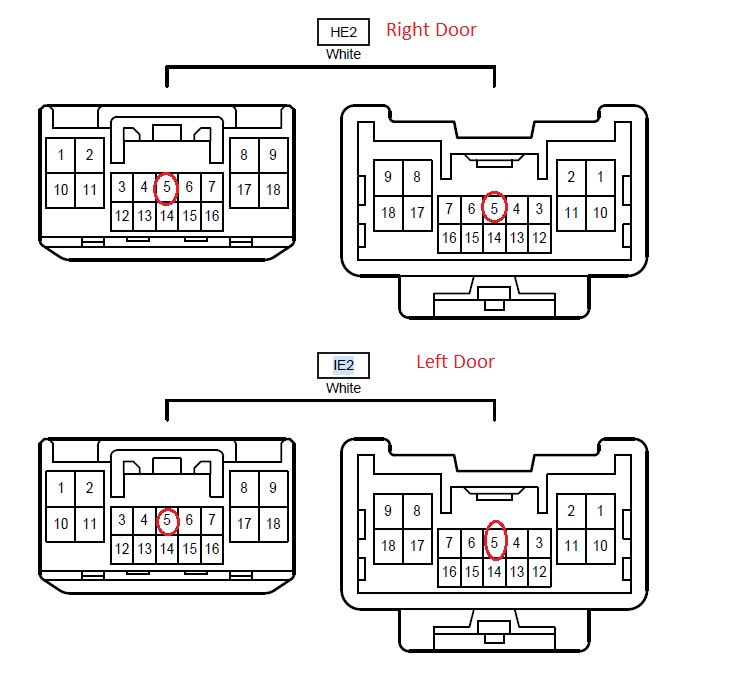

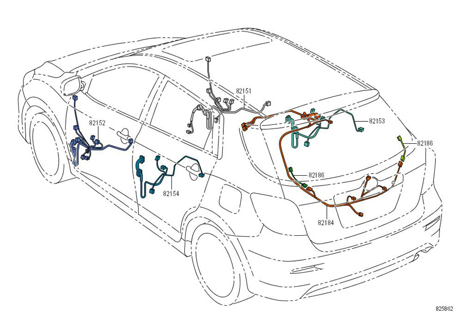

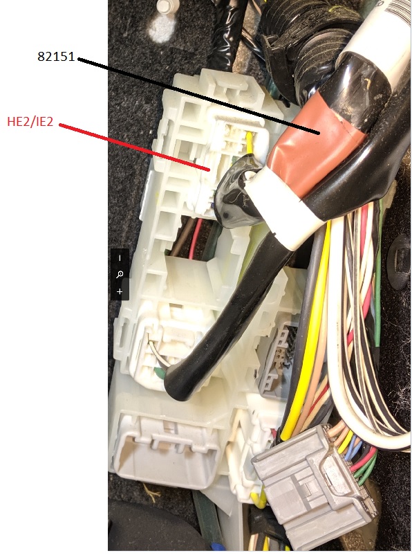

Journey of finding all the plugs in hope somehow they are somewhat pre wired......chances is getting slim
looking at the harness 82151 from the above diagram
HE2 plug(not IE2-correction) should be at the "burnt orange" colour electrical tape
One interesting observation, Toyota does know how to proper position their electrical wire away high humidity area(avoid condensation from the floor board..etc). All main power wire harness are routed across top of the dash behind pax air bag and radio areas. In theory you could find a flooded title and can be drivable for many years as long as the water line dont go pass the red circle area
IE2 Overivew.jpg (156.62 KiB) Viewed 150719 times

cq358
Posts: 348
Re: Valve Cover Gasket and swaping Heating Mirror from
Post by cq358 »
Close up
No Sky Blue wire, no pin nada..=(
next step has to find the "2M" terminal
