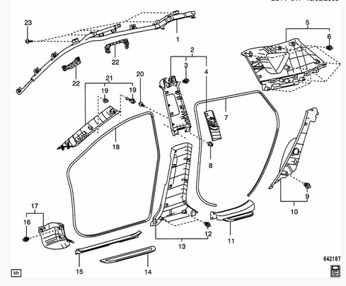

I am not sure if you are talking about the sill plate or the door cladding. If it's the door cladding look here: viewtopic.php?f=28&t=44681#p507900
Just like zbyers said.
The sill plate probably pops out. Look for screws first.
Posts: 10265
Re: Driver side front door threshold rusting...
If you're asking about number 14 in the diagram, there are no screws. I've never taken that part off, but if I did try, I'd pry gently with a screwdriver and hope it pops off without breaking
