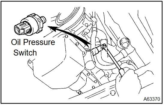

Mark wrote: ↑Sat Apr 13, 2019 5:41 pm is the sending unit difficult to replace?
The only procedure the matrix manual shows is
"REMOVE OIL PRESSURE SWITCH ASSY
a)Disconnect the oil pressure switch connector and remove the oil pressure switch"
with this picture
Looks straightforward, if you have a socket that fits

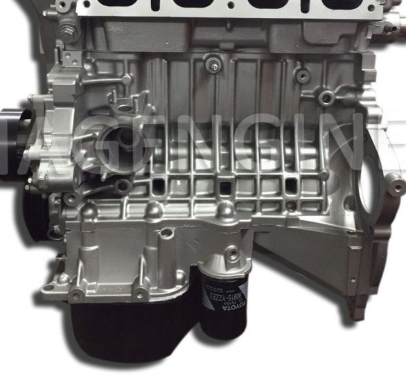

I can't find anything that shows the removal of the surface that the oil filter attaches to. This picture ( from https://magengines.com/product/engine-t ... z-fe-vvti/ ) shows the oil filter and what it mounts to on the base 1zz engine, and it looks to me like its just part of the engine block, not anything separately removable

Thanks, that picture actually helps to clarify. I just wanted to make sure that the oil filter mount wasn't bolted to the block and maybe needed a new gasket.
