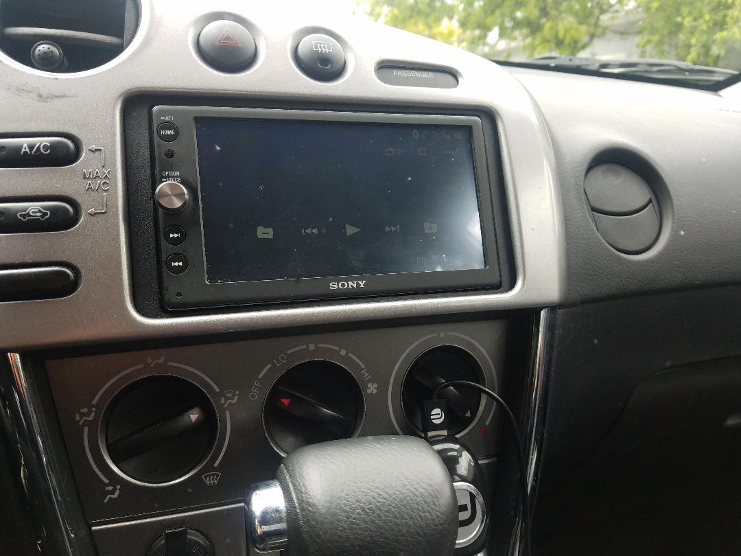

RubyVibes
Joined: Mon Jan 07, 2019 3:38 pm
Location: Reno, NV
Re: Would like a bluetooth + better stereo installed
Post by RubyVibes »
Hey guys!
Did it! Thanks for all the recommendations. Went the Crutchfield route, and it's been a pleasure. Will try to upload a photo.
Thanks again!
Vibe stereo.jpg (101.86 KiB) Viewed 4522 times
Ruby
Posts: 8442
Good job on the install, it looks great!
That's quite the stealth mounting location for the bluetooth mic. How's the sound on the other end when running the fan?
