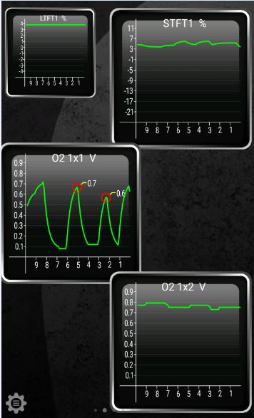

I took some PCM readings with Torque and it seems the second/downstream O2 sensor is reading high when ilding, around 0.75-0.8V. I also have high-ish short term (4-7%) and long term fuel trim (4%). Not sure how to interpret this downstream 02 reading.
When revved to about 3.3k rpm, the second O2 voltage does come down to 0.1, upstream 02 is still changing a lot, the short term trim changes around between what looks like -5 % and +1 %, long term trim is still 4%.

My exhaust leak was the exhaust manifold outlet donut gasket. As for the cat outlet sensor, I don't think the actual voltage is important, as long as it's not jumping around like the inlet sensor is, then the cat is doing something productive.

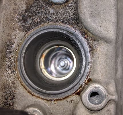

First the spark plugs. Yes, anything I touched in the past is suspect! :) However, I found nothng wrong, torqued to spec (18 ft lb), and noted they all tended be in pretty clean environments. See photo.

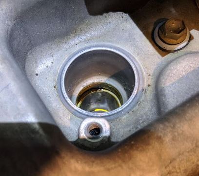

However, I did note they had some oil seeping where I think the valve cover gasket is. Am I right? Would this warrant a change of gasket? I think you can see this in the photo below:
spark plug oil.JPG (33.69 KiB) Viewed 5907 times

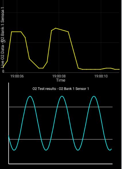

Now, the 02 sensors. There are apparently several ways to log this behaviour with Torque. One is real-time data, then there is a Test mode for 02 sensors, there is a graphing feature, logging feature, and a plugin called realtime charts or something similar. I don't know how accurate these are, seems the highest resolution is 100ms. I think the O2 sensor works but may be "lazy" or "slow" but I don't think any of these are definitive.
Here are two plots. First is from the realtime data
O2 realtime.JPG (41.67 KiB) Viewed 5907 times
this one is from the 02 test:
O2 test.JPG (32.39 KiB) Viewed 5907 times
Does it look like the voltage doesn't go high enough?
Might this be a setup issue with Torque, a question of scaling?
Is it perhaps not fast enough?
I could try to change the O2 sensor, but I don't want to randomly start replacing things.
