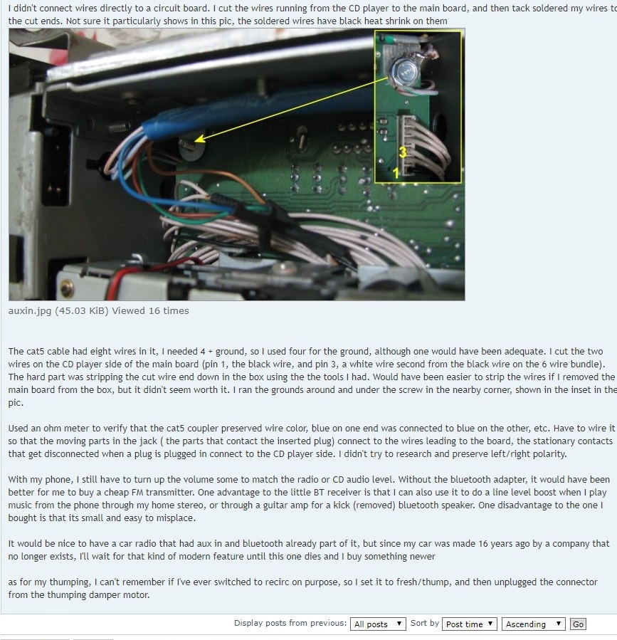

I'd just wire in a new aux port to the cd player input into the main amp. I plan to do that to my factory radio once the parts arrive.

I'm thinking internally in the head unit, where the cd player connects into the main board, before the main headunit amp. Your head unit may vary being much newer than my '04. Props to Joatman for the image.
