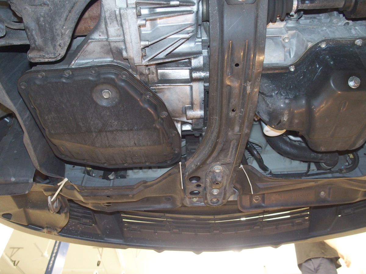

2018 06 10 - 01.jpg (398.25 KiB) Viewed 10218 times
...some of the splash guard fasteners are missing. I suspect the fasteners were removed by an over-zealous quick-change-oil-artist. I took this picture when we were inspecting the car in my shop after my son made the purchase.
I'm sure there should be a few plastic "rivets" or "clips" that should be players and maybe a bolt or two. I've looked on-line trying to determine what the stock fastener situation is but the on-line parts diagrams have lacked in detail as to the actual positions of the required fasteners.
Is anybody able to take a picture of their splash guards and/or scan a page from a shop manual that shows the information needed to fasten these splash guards correctly?

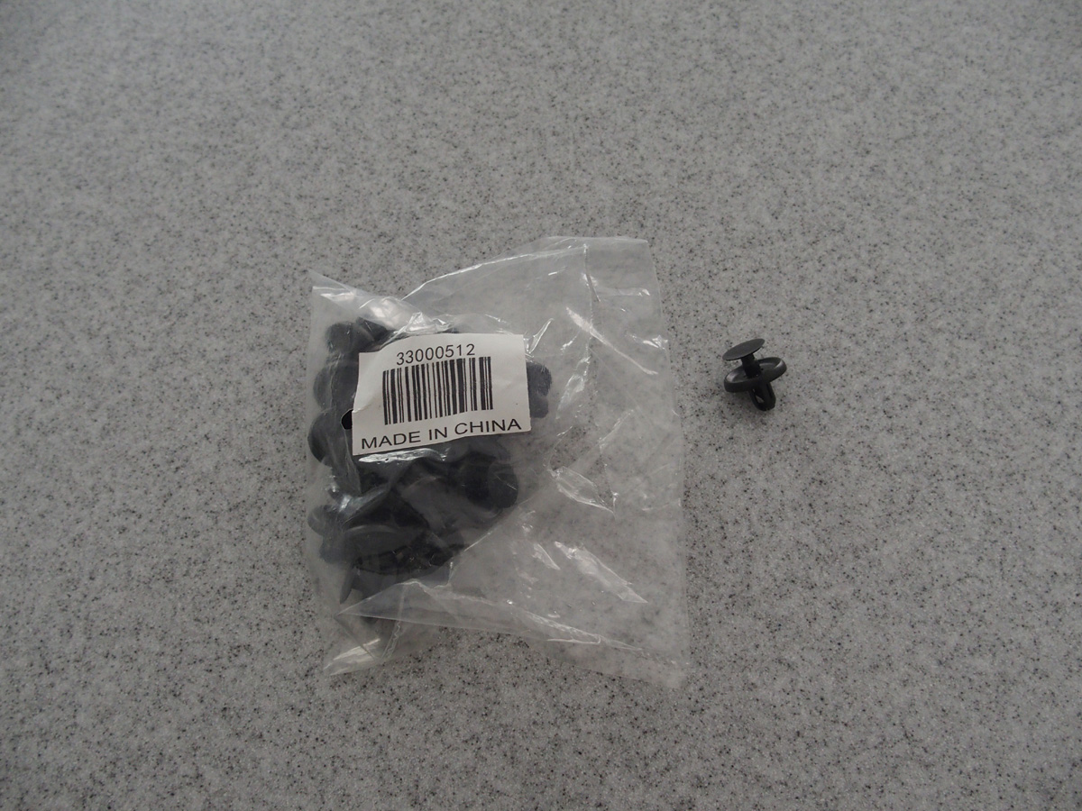

I ordered 25 generic equivalents of the Pontiac 88970767 Clips from a seller on eBay for less than $5 delivered.

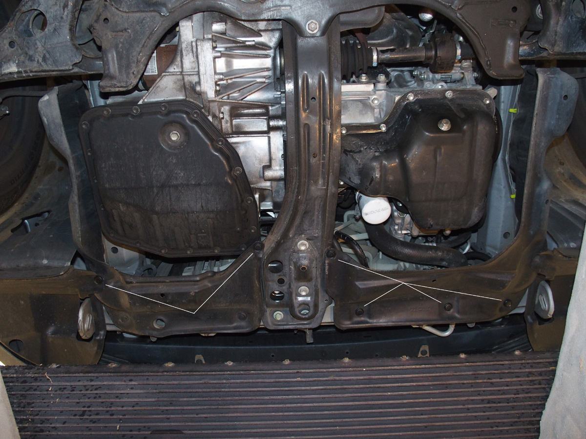

2018 06 20 - 01.jpg (427.97 KiB) Viewed 10119 times
As suggested by others, if there was a hole that looked like a clip would fit - I placed a clip there. White lines point to the 6 clips I installed.
So far they are doing their job.
