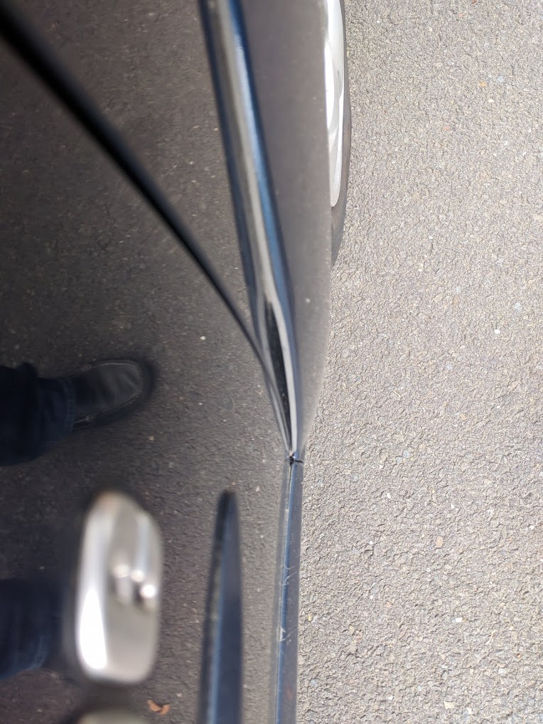

However, the reason for this post is the more I look the more issues I find. Today I noticed that the flare piece is not stuck properly to the fender near the bottom by the door. Now I'm worried about water getting in and starting corrosion. (Here's a picture as viewed from above. It's not easy to see but I think the aperture is big enough and oriented so that rain would get in.) Any ideas if something will rust, or how to properly seal this? I could apply some glue but not sure what kind and if first the thing should be taken off and inspected.

Re: Fender dents
i don't see that causing it a rust issue. you can run around without the flares and be just fine.
