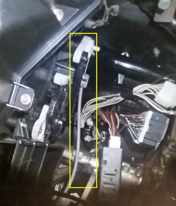

The other end of the cable is attached to the driver's side of the airbox, roughly straight up from the gas pedal. Here's a pic looking up from around the gas pedal, the yellow box shows the cable attached to the plastic arm of the door.
It's possible to reach up there with one hand and use the other hand to rotate the mode selector knob to verify that the moving the knob causes the plastic arm on the door to move. If it doesn't, then there is a problem with the cable, either broken r disconnected. If the knob moved the arm and it has no effect on the airflow, then there's something unpleasant inside the airbox, a disassembly and repair task that I don't envy

Joatmon, I believe you are onto something concerning the picture you shared. Now I know where to look to see if the knob is moving the lever.
I will check it this weekend and report back. My hope is it something as easy as putting the cable back on.

Joatmon:
Your picture helped me find the problem. The cable indeed had slipped off the door lever. All is working as it should now.
