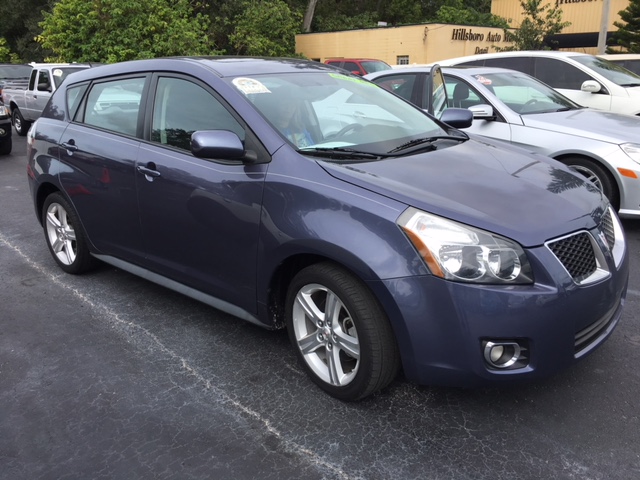

The only photos I have so far are the ones I took when I was at the car lot to show my daughter. It's very clean. Not sure what you'd call the purple/blue metallic paint but it's not bad.
I have some of the interior and back as well but they come out sideways when I upload them. I'll get some more photos when I get it back from the shop today.

Welcome to GenVibe! FYI, the name of the color is Steel Blue Metallic. My mom's 09 GT is the same color. Feel free to check out our Garages listed below in my signature. I've done quite a bit to both our 09 GTs over the past 8.5 years, so have a look around and let me know if you have any questions ;)!
