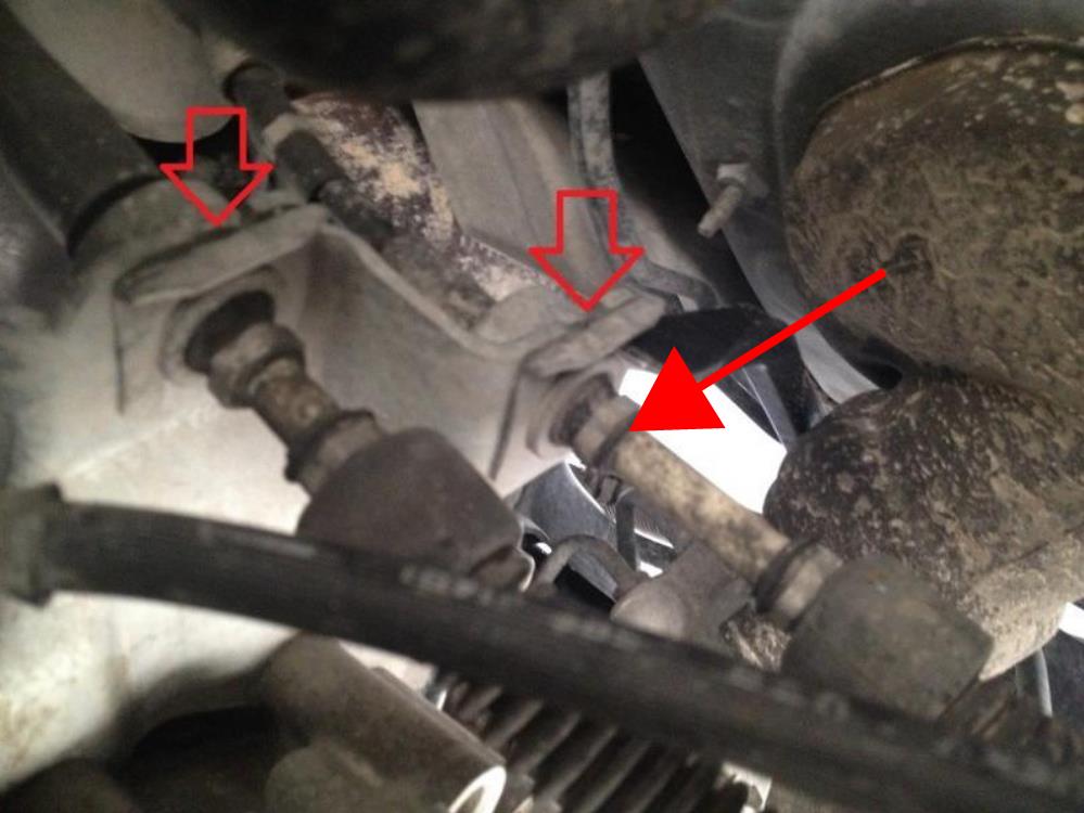

I also ran in to a couple issues, one being that I snapped one of the shift cables, see attached. The small white tube on the rear cable broke off right where I have the solid red arrow in the photo. I don't think I can repair it since it broke off flush.
Does anyone know where to source a a replacement cable or have a repair recommendation?

Pop that spring clip up and off to see what the damage is and to think about possible fixes. It might be obvious when it is in your hand. The clip is one like the brake line clips, it's next to your hollow red arrow.

Also, I think I may have sourced a new unused shifter cable for $30 on craigslist. He is getting the part number tonight so I can verify, but in the picture it looks like the correct cable (rear )from diagrams I've been looking at. Hopefully it will be installed on the vibe by Thursday. Just a bit of a trek to Colo. Springs from Denver. https://cosprings.craigslist.org/pts/d/ ... 20652.html

I installed the replacement shifter cable last night, and all I can say is what a PITA!! It took me over 3 hours to complete the installation. I spent about 2 of those hours messing with the grommet where the shift cables enter the cabin. Whoever designed it needs to be taken out back to the woodshed! My advice, is to NOT BREAK a shifter cable in the first place!
