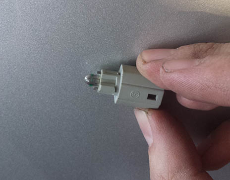

Socket Ring (for those who have the cigarette lighter option, where there's a green light up ring around the socket)
I have no idea what bulb this is. I'm likely to just use suitcase joiners to tap some LEDs into this. I'll post what I do later in this thread. BTW the image below, the bulb normally is covered in a green rubber cap, I just removed it.
