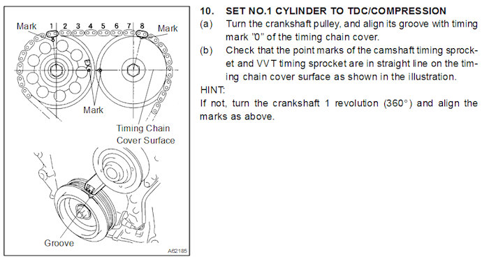

Where the file cip1346.pdf is saying about checking the timing of the camshaft in relation to the crankshaft, here are the timing marks for the 1zz-fe engine.
cam timing 1zz-fe engine .jpg (93.24 KiB) Viewed 5367 times

I was going to check that today and cylinder compression test too.

Ok here is an update. I took the valve cover off and started turning the engine over by hand and the timing chain would up the teeth and would get loose. So there is something wrong in the timing chain. Will the valves and piston hit each other?
jolt
Posts: 984
Re: 2003 not start
Post by jolt »
You can read this:
viewtopic.php?f=17&t=46117
To quote the first line "So my wife drove her 2005 Vibe base until the timing chain snapped and bent the valves." and most dual overhead cam engines use a chain because of the valve interference. Even old V8 engines could bend the valves if the timing chain jumped a tooth or two. Old Buick's were bad it this. As a general rule (but not allows true): If it has a timing belt and is newer then 2000 year model, it is a non-interference motor; and if it has a timing chain, it is an interference motor.
If you need to pull the head be sure to read the whole topic in the link above with the TSB on the cam timing and updated gear.
The timing chain has a hydraulic tensioner on it. The chain can get loose on the back side of the rotation when turning by hand but should never be able to jump teeth on the gears. Parts wear out with mileage. The chain links wear and stretch along with chain guides wearing out. All of this can cause the chain to get looser than what the hydraulic tensioner can take up and you get a timing chain that has jumped.
