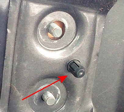

I've never taken that off. One pic shows the glass and spoiler with the four T30 screws in place, but you said you took those off in the first pic
There's what looks like some guide pins in the hinge between the two bolts, could they be catching?

I uploading this last pic....i'm pretty sure the problem is that the hinge that attaches to the rear glass (no bolts or screw access as seen) is preventing me from lifting off the spoiler...
Posts: 10265
Re: Argh. Why can't I remove my rear hatch glass liftgate??
Could it be hanging on what looks like spoiler guide pins that stick through the hinge?
