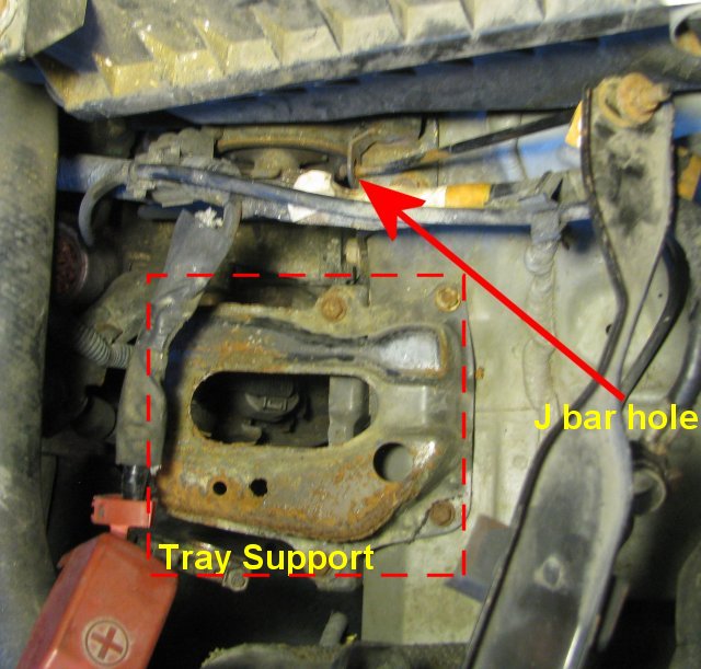

Before you order any more parts, compare your 03 Vibe to this pic of my 03 vibe taken from the front of the vehicle. I have the battery and the plastic battery tray removed to show what's underneath
Notice that the hole where the J-bar hooks on to is actually part of the motor mount (well, technically a transaxle mount) under the air filter box. The bar goes down between the air filter box and that horizontal cable bundle
The battery tray support is fairly minimal, however, if your car doesn't have one, the battery would fall to where it would hang from the cables
Here's another pic, taken from the side
That hole for the jbar is apparently non-intuitive, as I and a number of other people had significant trouble finding it, so if its there and you didn't notice it, don't feel bad, sucker got me and bunch of others too.

Thanks for responding and with pictures! That helps alot.
When I put the new battery hold down bracket on and tightened it up to the frame, it was approximately 1-1.5" taller than the top of the battery. I looked down behind the battery for a place to put the j-hook and didn't see anything there. I ended up putting the j-hook on the motor / trans axle mount, like you have suggested, as it seemed like the only place I could use. Unfortunately, when I tighten the nut all the way down on the j-hook, I still have that 1-1.5" gap between the battery hold bracket and the top of the battery. The battery and the tray underneath will slide around unless I put a piece of wood on top of the battery. Looks kind of nasty and not sure what it does to the structure of the battery long term.

Despite the rain last night, I was able to check and I do have an existing battery tray support underneath the battery. Thank you for the picture as the diagram image does differ from the real thing ("Your results may vary" I guess is the operative phrase there).
I believe that your train of thought about the actual battery size may be the right one. I have a Autocraft 26R-2 battery that came with my car. https://shop.advanceautoparts.com/p/aut ... fragment-2
Not including the the terminals, the battery housing is approximately 6 15/16" in height. Measuring from the bottom of the angle irons on the hold down bar, it is approximately 8" to the tray. That would make the 1" difference between the two that I have been experiencing. The Autocraft site says that the battery does work for my Vibe but it is not one of the two you mentioned that are the regular ones.
