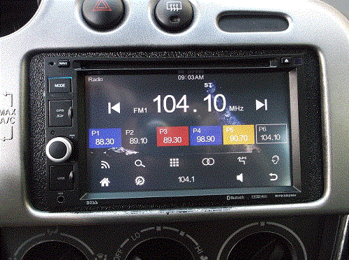

Here is the finished radio install showing the laser cut ABS bezel.

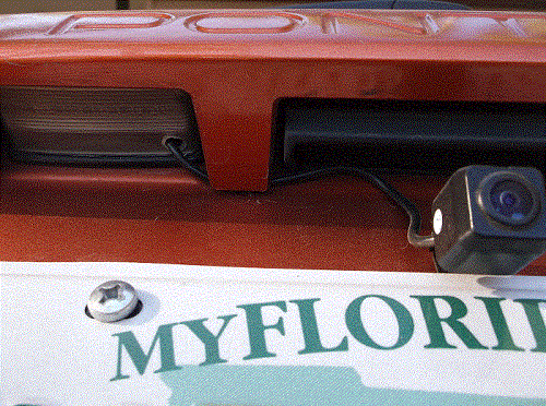

The finished camera install showing the cable entry thru the light lens.

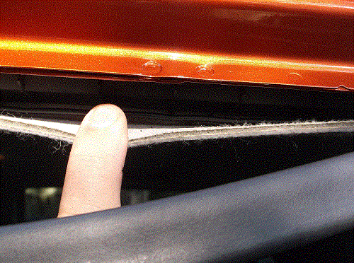

The wire running along the edge of the headliner.

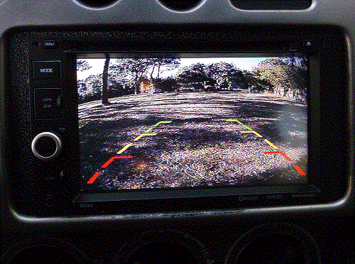

With the camera activated.
