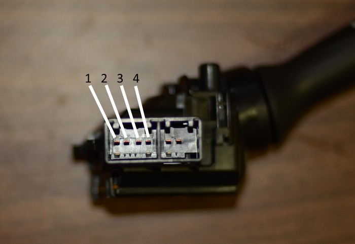

If you want to test the switch, you can unplug the connector that goes to the switch on the steering column, then short the following pins to activate the different modes:
1 and 3 = high
2 and 3 = low
2 and 4 = intermittent
Refer to pic to see which pin is which.
If in the unlikely event the switch is bad, you can have the spare I have for the cost of postage.
