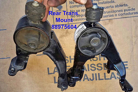

Front and rear mounts.
Rear Mount - Reduced - WithText.jpg (107.14 KiB) Viewed 19300 times
Front Mount - Reduced - WithText.jpg (95.7 KiB) Viewed 19300 times

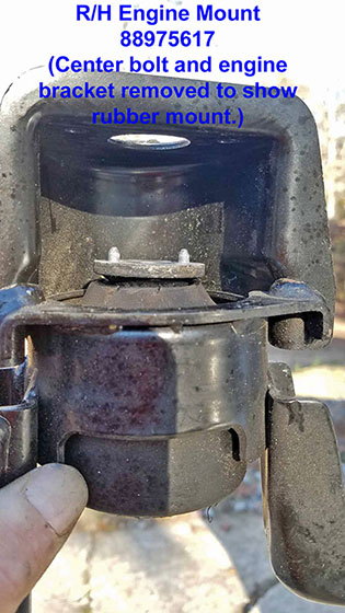

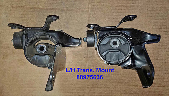

Left and right mounts.
RH Mount - Reduced - WithText.jpg (103.26 KiB) Viewed 19300 times
LH Mount - Reduced - WithText.jpg (88.02 KiB) Viewed 19300 times
