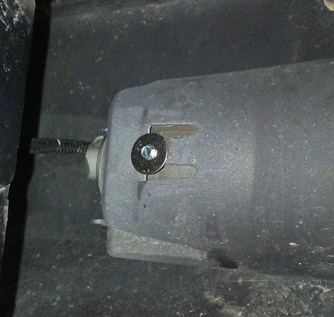

fog light_zps747eeqio.jpg (47.46 KiB) Viewed 6151 times
Fog lights won't stay in properly so I took a washer and a screw, and drilled a small hole into the black caps and then put the screw in. I only needed them for the inside of the fog lights. I made sure to drill in the very center of the black cap, because there's a small cavity in the fog light metal under the center of the cap.

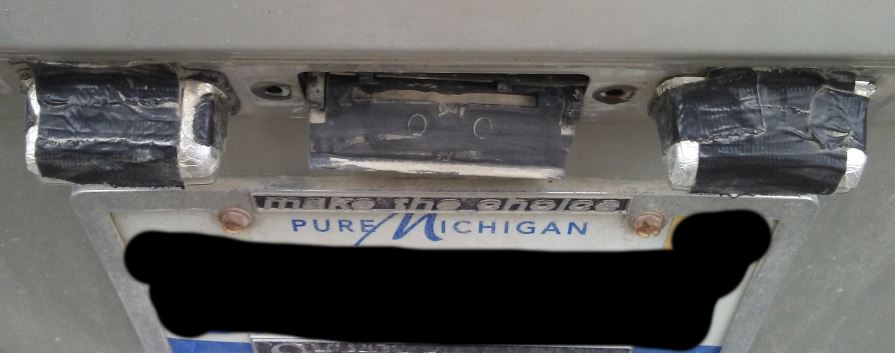

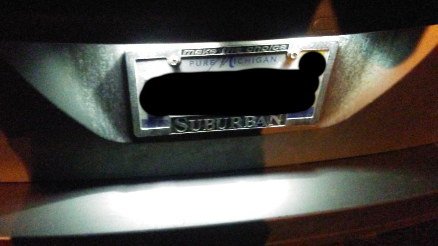

license light covers_zpsfdiypwwt.jpg (39.57 KiB) Viewed 6151 times
license lights_zpssebekfrc.jpg (53.32 KiB) Viewed 6151 times
I replaced the licence plate bulbs with LEDs: https://www.superbrightleds.com/moreinf ... t-car/199/
Then I covered the lights with aluminum foil and duct tape, so that way the light wouldn't shine upward through the crack in the trim piece that sits on top of the lights.

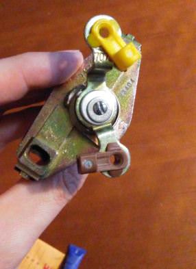

I also cleaned out the hatch lock as it was frozen solid. Lots of penetrant and prying with a screwdriver inside and the inner cylinder finally came out. Ended up sanding the inside of the cylinder and the inner cylinder shaft, wire brushing it and polishing it. Had some of the lock sliders pop out of their grooves. Thankfully was able to get them in the right positions again. Polished the front of the lock, lubed everything up with a lock lube, and put it back together.
I had broke part of the tab that holds the c-clip on the back, so I drilled a small hole, used a screw and washers and blue threadlock, and put it back together. Works great now.

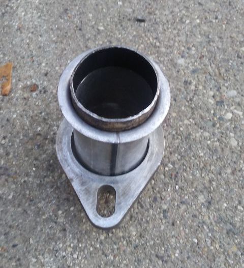

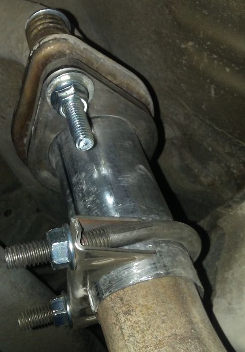

So my exhaust broke... at the rear flange. What do?
tail pipe_zpsrq4ff5hh.jpg (31.53 KiB) Viewed 6151 times

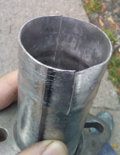

First off, I was able to get the old flange bolts out using penetrant, a torch, and a breaker bar, which was amazing. Getting the old flange gasket out, however, required more penetrant, heat, and chiseling it out with chisel and hammer. Took forever.
To fix the broken flange I used Walker 41727. I had to cut the flange adapter in half because it was too long and due to a bend in the tailpipe just after the flange. I also had to cut notches lengthwise in the flange adapter due to it being slightly bigger than the tailpipe. This would allow the adapter to clamp properly on the pipe.
I also cut off the old broken flange and about 2 inches or so of tailpipe past it to give room for the adapter. I cut about an inch of the tailpipe section I had removed, and hammered it into the flange end of the adapter. This gave a spot for the new gasket to sit on the flange properly.
To finish it off, I used an exhaust clamp, and new bolts, nuts, and washers for the flange itself (I used the old springs because I couldn't find the right ones new, and they were fine). And it's worked fine ever since.
