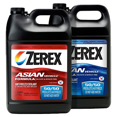

- Speaking of fluids, orange coolant?! It's a Toyota engine so why Dexcool? Do the vibes come with Dexcool factory? If not, I'll probably flush it before the end of the year.

I suggest you do the fluid changes earlier rather than later. Get rid of the dexcool right way. It's a Toyota not a GM under the hood. Get an Asian Formula coolant or the Toyota coolant.

vibrologist wrote: I suggest you do the fluid changes earlier rather than later. Get rid of the dexcool right way. It's a Toyota not a GM under the hood. Get an Asian Formula coolant or the Toyota coolant.
A friend of mine who works as a mechanic at a Chevy dealership says the Vibe came with dexcool and should stay that way. Also, looking at manuals for the Vibe online, GM says either Spec 1825M or Dexcool. I am quite confused. I have not seen the asian coolant anywhere.

Dexcool: I am confused now as well. I believe the things I read here at the forum are trustworthy. I will avoid dexcool:
