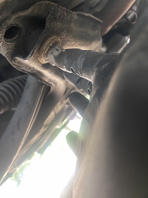

i own a 2004 vibe gt and have that same problem, but only when i go in reverse and turning,
i replace lower control arm, sway bar, tie rod ends, inner and outer, struts and stil have that pop but last sunday when i was changing the motor oil i found out that a bolt tha contect the front sub frame to the frame was loose but when i try to tight it up it wont, looks like the threted part of the frame broke loose !!!
what can i do?
Posts: 610
Re: Front end creaks and pops
You probably need help at a body shop. That bolt attaches the front crossmember to the floor side member. The torque section of floor member is probably toast. One solution may be a permanent weld.
