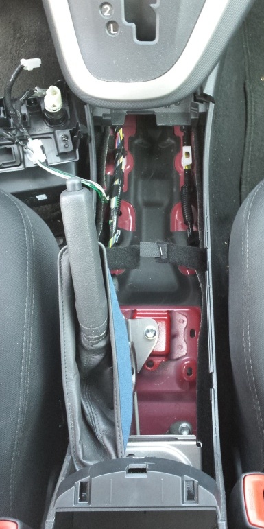

3. Remove the cupholder/e-brake section. Pry along the edges of the top with your fingers or plastic pry tool; it pulls right out. The e-brake skirt has a metal ring that pops into grooves in the plastic, just slide and pop the whole thing out. The skirt stays attached to the e-brake handle. Engage the e-brake to allow enough play to remove the panel to which its skirt is attached.
4. Pull the front bin straight towards the rear of the car. The entire section along with the 12V and 115V outlets pops out. Tie into the 12V outlet wiring here for additional 12V stuff you're adding to the car or center console. Twist and move this to the driver's side footwell so you don't have to disconnect all the wiring and cut the ties.

With the cupholder and front tray removed
