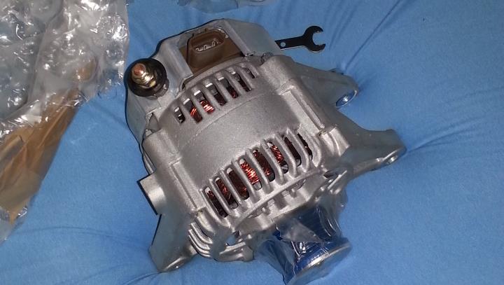

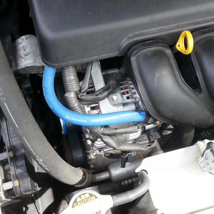

So this is what I got done so far, all in all.
I put this baby in. Delivers 132A @ idle and peaks @ 185A.
alternator
alternator
Charge Wire 1
Charge Wire 1
Charge Wire 2
Charge Wire 2

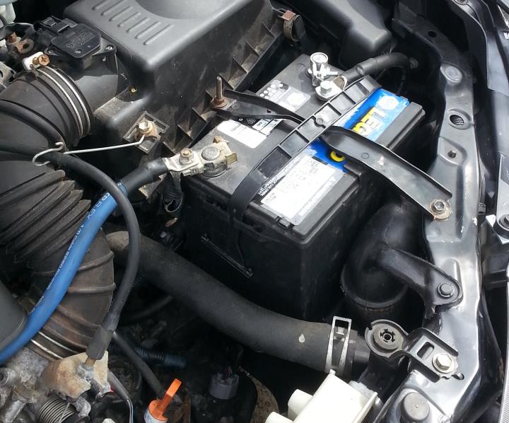

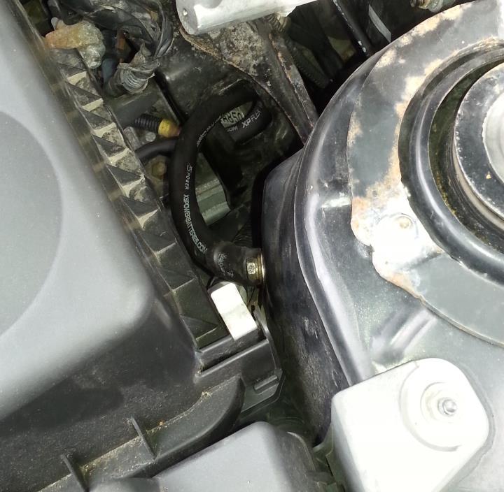

And here is my upgraded ground. I ripped out the old ground terminal/cables and just ran a new single path from Battery Neg. -> Engine Block bracket - > through to the block ground bolt - > New Ground location on strut tower.
I was going to keep both chassis grounds at first, but then when I saw the battery-> chassis ground was undernearth the battery tray I knew I wasn't going to be able to fit 1/0 gauge wiring back in there... My mechanic seems to think it is pretty well grounded and going from both the battery and engine block to chassis isn't needed and not often seen, but I'm not so sure. I may decide to add a battery terminal to chassis ground back into the system but so far everything runs and works properly.
Ground to Chassis
Ground to Chassis

Uh-oh, is that speaker wire?
BustedVibe
Posts: 139
Location: Wisconsin
Re: My Audio Upgrade Thread
Post by BustedVibe »
Pretty big I know :mrgreen:

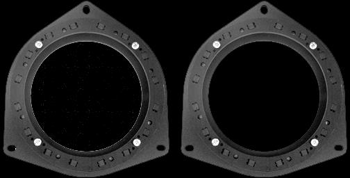

I've been considering for a while, purchasing some custom made mounting brackets for when I put new speakers into the car.
At the very least I'll need one set for the front doors.
Has anyone used something like this? http://www.car-speaker-adapters.com/items.php?id=SAK036
They basically mimic the OEM mounting brackets which I think will make it a lot less painful to put them on the door. Put some sound deadener on them to deal with any vibrations between the door and speakers and get the right screws to replace the rivets.

Did you ever end up getting the speaker wire through the rubber door boots? Also where did you purchase the alt from? brand? Did you have to replace the belt with a shorter one do to smaller alt pulley?
Thanks!
BustedVibe
Posts: 139
Location: Wisconsin
Sorry I kind of forgot about this place for a while..
I have not progressed beyond an alternator purchase and install.
I got my alternator from Mike Singer, ( www.singeralternators.com ) He hand builds them using factory casings, offers drop-in replacements.
It went in without any problems. We did have to use a slightly smaller belt than OEM but my mechanic said it fit perfectly. I forget what size the new belt was though.
