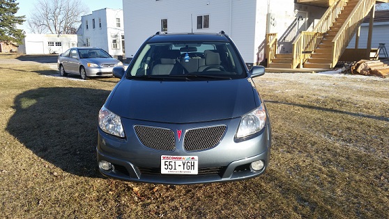

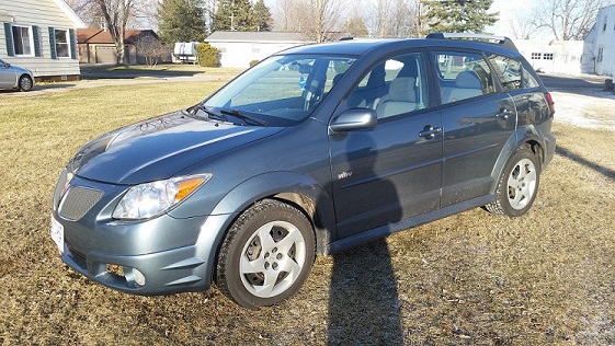

Just purchased a Stealth 2007 Vibe with 111K (will post picture when I get home from work) and I had a few questions regarding some modifications that I plan on doing in the near future. I'm sure there are already threads for a few of these topics so if you could point me in the right direction it would be much appreciated! First of all, I have to get rid of the ugly steel wheels. I don't have much money left after purchasing this car (still in college), so what wheels would you recommend that look good and are reasonably priced? I don't want anything flashy, just something that will improve the overall look. Secondly, I noticed there is an aux button on the stock radio, although there is no auxiliary port. Why is this, and is there anyway that I can connect an auxiliary cable? I don't have much experience with wiring, so it would have to be fairly simple for me to look into it. Lastly, I'm thinking painting the roof rack black and I was wondering how difficult it is to remove/reinstall it. Thanks in advance for the help! I think I'll be spending a lot of time on this forum in the coming months...
EDIT: Took a couple quick pictures while the sun was shining today. I also noticed that I was missing the bottom grill on the driver's side after taking these pictures. :lol: I'll have to get one ordered.

With the wheels I suggest you keep a CL search going in For Sale-Auto Parts-Wheels and Tires under the term "5x 100". The smallest diameter possible is 15" and the largest sensible diameter is 17".
Here is a Wheel Cross Reference site: http://www.roadkillcustoms.com/hot-rods ... z44FWsFDY0
Watch for the center bore and offset.

Welcome and congrats on your Vibe! Agree that you should look on craigslist, and most Scion tC, Matrix and Corolla wheels will fit and look nice. The alloy Vibe wheels are 7" wide in 16" and 17" models. I've looked on www.car-part.com for wheels too and found a set for a local guy on there. When he went to see them, they had curb rash so he bargained them down to like $35-40 each. Using a sander and sand paper he was able to clean up the curb rash so they look much better. He got the same wheels that I have on my 03 GT. If you found some that are kind of worn, you can always spray paint them or plastidip them.
