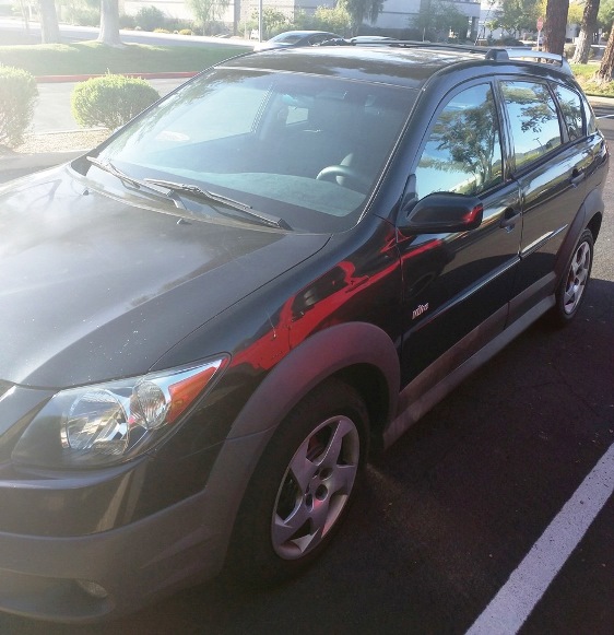

Robert1Stock wrote:just snapped this one when because I saw you guys asked for one :).
Thanks again!
Picture ??????? :?:
Robert1Stock
Posts: 10
Joined: Thu Mar 10, 2016 9:59 am
Re: 2004 Vibe Base Model, Restoration Project
Post by Robert1Stock »
MyVibe
MyVibe
Sorry, had to bring it down to 5% original size :) . I will take better pictures while I am doing some work on it this weekend.
