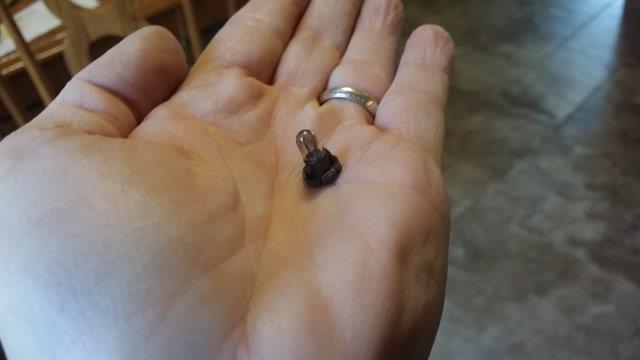

Thanks. Well I found that they do twist and as you stated "be careful". Before I saw your reply I dropped the bad one into the dash when I loosened it up. I also took out the good one just to get a look at what it was since the other went into the abyss.
What a bad design to say the least. These things have to be inserted and removed from the back of the mount! If I could figure out how to remove that white mounting bracket it would be easier. It appears it clips in from each side but I can't see how it does. I am afraid to put too much pressure and break where it mounts.
Can you tell me where can I get replacement bulbs? I am thinking it might be better to replace these with leds rather than the incandescents.
