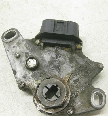

They don't call it transmission range sensor. They call it Neutral safety switch. It is on the trans axle where the shift cable comes in. It looks like this:
neutral safety swithch.jpg (25.21 KiB) Viewed 6150 times
