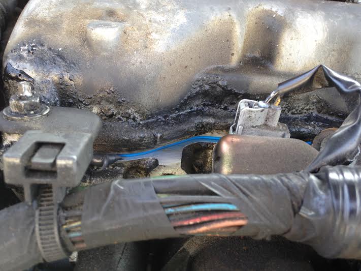

I have a question about installing a new valve cover gasket. In trying to put the cover (with the new gasket) back on, I could not get it to close all of the way. You can see it here, the gasket is the blue line:

I'm pretty new to working on cars and I have a lot to learn but this can't be correct...can it? I'm afraid to tighten anymore because I am using a lot of force (I think my torque wrench isn't working properly) and one of the bolts already snapped. The cover is lined up and the gasket is seated properly. I have driven it like this and it's running fine and it isn't leaking but shouldn't the cover be closed all the way and the gasket not visible?

I think that's the way its supposed to be, or at least I should say, I replaced mine a month or so ago, and I just went out, took off the plastic engine cover, and I have about the same amount of blue gasket showing between the block and valve cover.
Sucks about snapping off one of the bolts, but you could just keep an eye on it and if it doesn't leak, it's probably ok. I'd be inclined to take the cover back off and see if I could get the broken bit out and use a replacement bolt. I don't remember what the thread or length of those is, but you can probably buy one at a hardware store. If you do pull it off and replace the bolt, remember to clean off the old and use new dabs of sealant in the two little spots where the timing chain cover bolts on to the left side of the block,
