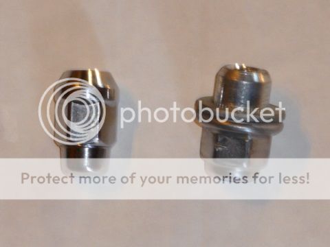

Hey, those are my wheels! Did you get the correct lug nuts for those?
The nut on the right is correct for those wheels.

MrWhoopee wrote:Hey, those are my wheels! Did you get the correct lug nuts for those?
Good point! Important to use the correct lug nuts on these Toyota alloy wheels.
Thanks for the lesson. Getting my stock nuts to seat on those rims was tricky, but they tightened down okay. Seeing your pictures made me curious about the differences, so I googled for more info.

Davicof wrote: These look like they'll fit right. http://www.canadiantire.ca/content/cana ... okoScYrKM8
MrWhoopee wrote: I picked up a set of New Beetle alloys with studded tires for mine.
Looks good. How hard is it to replace the center cap? I found a similar thread that says caps aren't the same size. viewtopic.php?f=31&t=30129
Yes, those appear to be the correct nuts. I assume that Toyota used the large washer to provide more contact surface with the alloy, possibly due to a strength issue. I would not run those wheels with a cone-seat nut, they may fracture and fail.

New nuts are on the wheels. So glad I got the unsafe one's off. Thanks for the help guys.
