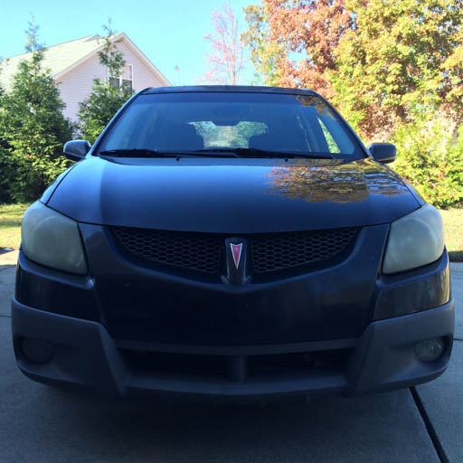

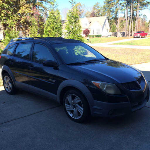

Well I found exactly what I was hoping to. A black Gen1 GT.
I had been search for a few weeks and one popped up on Craigslist overnight. The owner had bought it to, in his words "drive it till it stopped" which is what happened. The clutch went out on him and he didn't want to deal with getting it towed and having a shop replace the clutch after he was given a quote of $950 to do it. So he put it up on Craigslist for $1000. By the time I sent him a message someone else and already made an offer to him for $650 but had backed out on him. A couple hours later I show up with a tow dolly and pay him $750 for it.
I started a through cleaning of it today and noticed a musty, damp smell to it. Found the source in the spare tire storage compartment. It appeared that the previous owner had spilled a litre of soda and had not cleaned it up. So I pulled the drain plugs and liberally applied water and elbow grease. No more musty, damp smell. I have left the doors, all five, open to give a complete cleaning.

Without further ado here's some pictures of her.
Pose (2 of 5).jpg (110.32 KiB) Viewed 7732 times
Pose (3 of 5).jpg (100.64 KiB) Viewed 7732 times

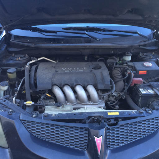

After washing her I pulled the hood off then cleaned the engine compartment up bit as well. I didn't notice any indications of oil leaks and all the wires, hoses, filters and belts appear in good condition.

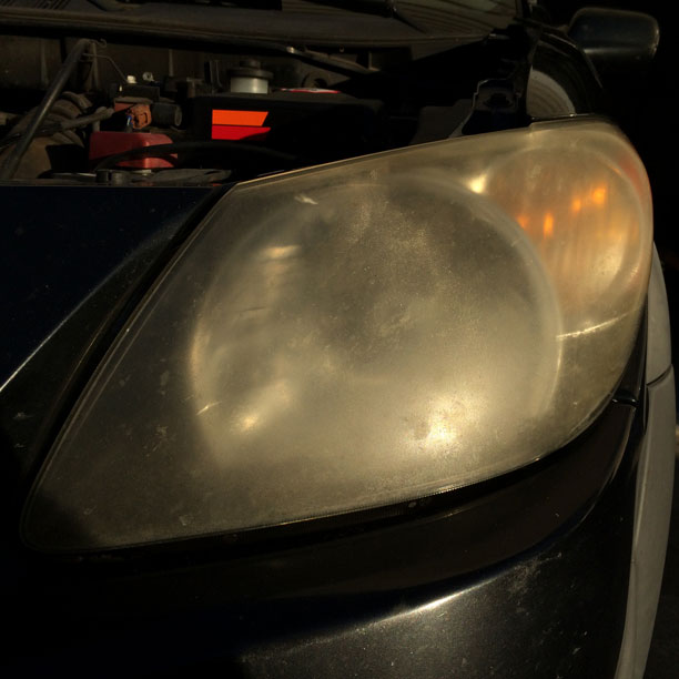

Today I also cleaned up the headlights. Makes quite a bit of difference in my opinion.

Re: RDUNick's 03 GT
That looks like a successful cataract surgery!
Vibenvy keeps waxing the lenses and it helps, she reports.

Excellent point. I have completed a test and each cylinder was indicating approximately 225 psi each. Lowest being 220 psi.

As long as they're over 200, you're good
Re: RDUNick's 03 GT
Maximum "acceptable" difference of PSI between highest and lowest cylinders is either 15 or 10. Spread is basically spot-on.
