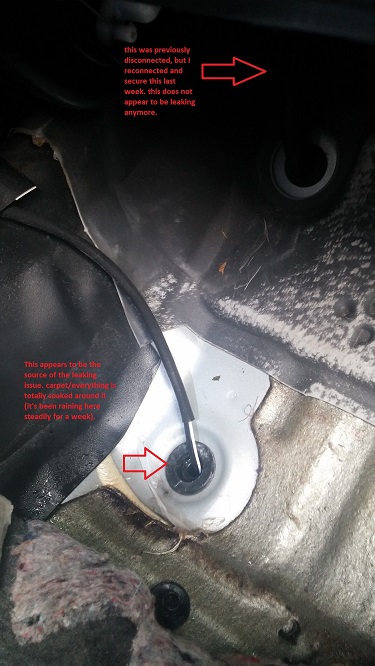

- I read the other threads about the AC unit has a tube that can become disconnected. Sure enough, it was disconnected. I have reconnected and secured (electrical tape) this but it does not appear to be the source of leak
- There's another plug about 12 inches below the AC unit's tube that appeared wet (shown in pic below). We had heavy rain last night and I checked it and it this morning and it did not appear to be the source of leak despite my comments in the picture (pic was taken before tonight's rain). Previously I thought this was the culprit because it was wet, but I'm thinking that's because the entire floormat was soaked and made everything appear wet.
- I removed some of the side paneling along the floorboard on the front passenger's side and everything appear normal - I didn't see any bad signs.
- I checked the two front moon roof drain plugs and they did not appear to be blocked.
- I touched the rear passenger side floor mat that runs up to the door and it does not appear to be wet..it's pretty much dry (indicated in pic). I thought it might be leaking in from a bad door seal or something.

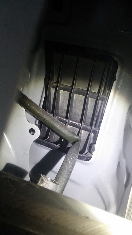

The item in your second pic, you thought might leak, is the lead from the Oxygen sensor off the exhaust pipe below the car. They almost never leak, but if it was replaced they may not have ties the end below the car tight. Sitting still, the grommet and lead would not leak, even driving it would not let in the amount of water seen in your Vibe. After you find the source of the leak, definitely want to air out the car. Lift up the carpeting at the edges and blow air under the carpeting. If left to its own, you will end up with mold and rust under the carpet.

joatmon - I used your wire idea. I used 16 gauge speaker wire. I took about 10 or so feet of it, split it in half (so just one wire) and then started running it up the back drainage tube/port behind the rear passenger wheel. There was little resistance at first - it almost seemed too easy. Then I started to hear the wire scrapping the side of the body, so I knew the tube would be disconnected somewhere.
If you open the spare tire compartment in the back, there's a little port where you can see the rear drainage tube connected. In my case, the tube was disconnected here. Additionally, the tube was bent/pinched at an almost 90 degree angle.
I reconnected and straightened out the tube.
What I think was happening is that the rain flow outpaced the rate at which the pinched tube could release water, so it eventually just overflowed out of the top of the drain and went down all of the side of my car and pooled up under the seats.

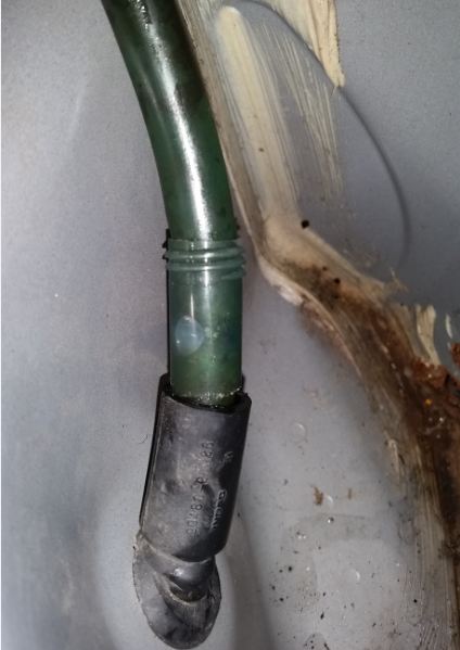

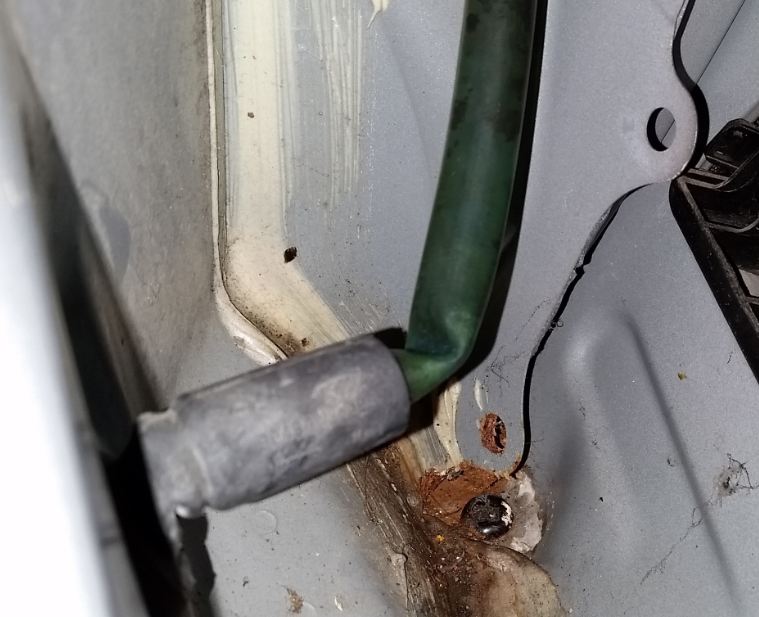

Here's the pics...
This area is accessible once you open the spare tire compartment.
If you have a similar problem to mine, be sure to check and make sure these drains tubes are properly channeling water out the drain port and that there's no kinks in the tube.

Thanks for the post! I have had this problem for at least 7 years and have been trying to trouble shoot it. I have a 2003 Vibe and we first noticed the back right passenger carpet was wet and sudsy after a car wash. I thought it was from the bottom blast jets in the car wash, and it may have been. When I looked underneath, the rubber plug at the bottom of the floor pan was missing. I went to a junk yard and picked up a couple of rubber plugs from a Vibe that had been totaled. I put it in place and thought I was done. At different times the carpet would get wet again in different situations. My daughter took the car to college so I was unable to watch and monitor it regularly. She would say it got wet on occasion. I looked at it multiple times in the summers when she was home. I was unaware there were 4 drain plugs in the sunroof area. I kept the front two drains open. I was told it was probably water intrusion from failing seams in the floor pan area or wheel well when driving in rain or on wet roads. I recently purchased her Vibe and drove it back from Texas at the end of 2016. Yep, in the 21 hour trip home we hit rain and wet roads and the back right carpet got wet. Thanks for letting me know there are 4 drain holes in the sunroof! Knowing that and looking at your pictures under the spare tire cover tray, the hose on the right was not only kinked but the black rubber drain connector was also bent at a 90 degree angle. The left hose was perfectly aligned, so the left carpet was never wet. Makes sense. I tried to unkink the right hose but the kink had been there so long it had a lot of "memory." I put a hard plastic tube over the kinked area of the hose so it would not ease back to its kinked state. I also rerouted the drain hose to the black connector so it connects vertically (instead of horizontally like it was). To make sure the hose was clear of kinks, I snaked a zip tie up from the drain hose behind the wheel and it had no resistance and I could see it through the clear plastic drain tube. I can't wait to try it in the rain and report back. See attached photos. Kevin
